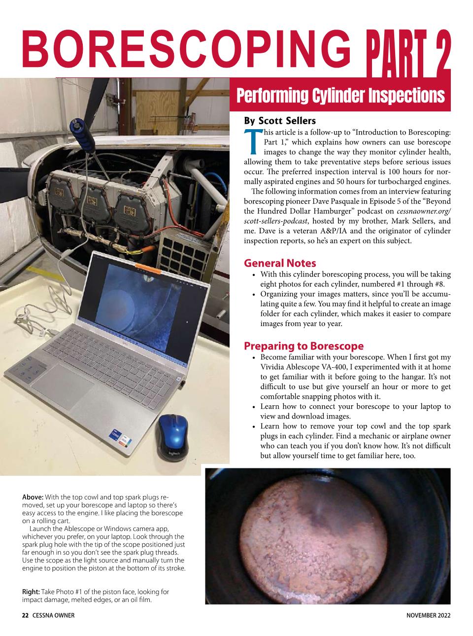

Borescoping Part2 How To Page 001.jpg (234.38 KiB) Viewed 477 times

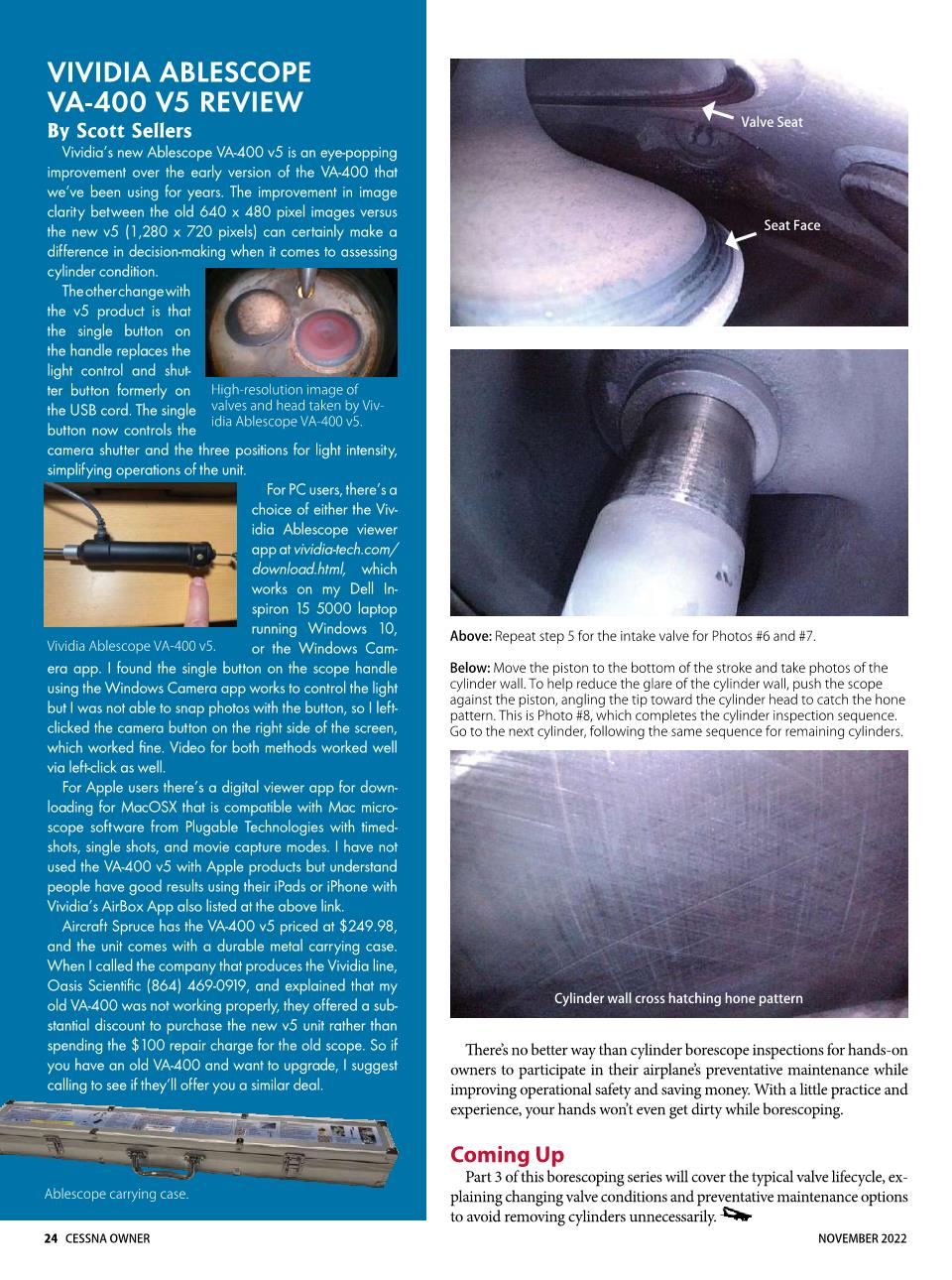

Borescoping Part2 How To Page 002.jpg (228.21 KiB) Viewed 477 times

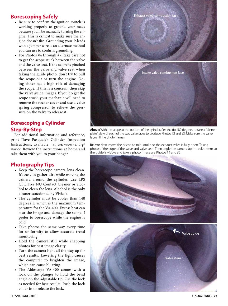

Borescoping Part2 How To Page 003.jpg (231.38 KiB) Viewed 477 times
