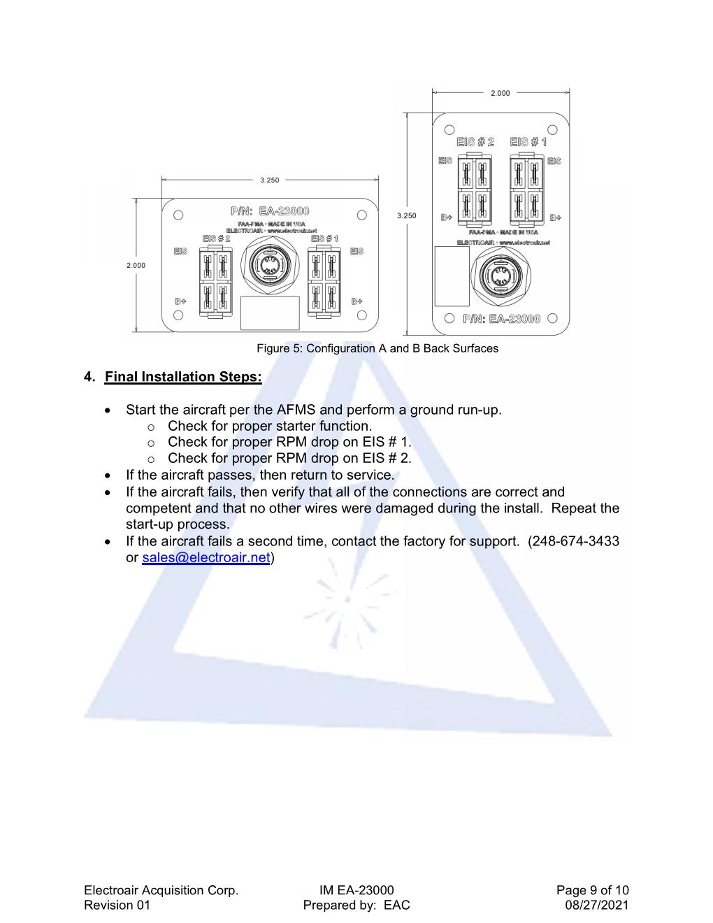

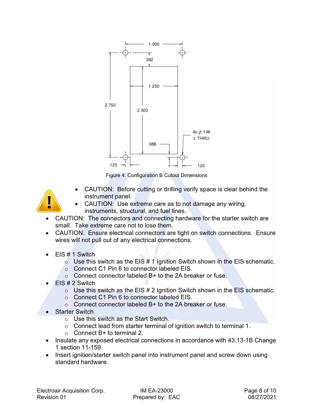

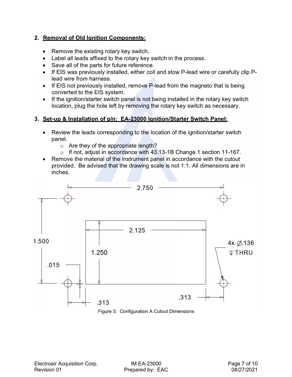

electroair Electronic Ignition replacement for 0540-J3C5D Dual magneto

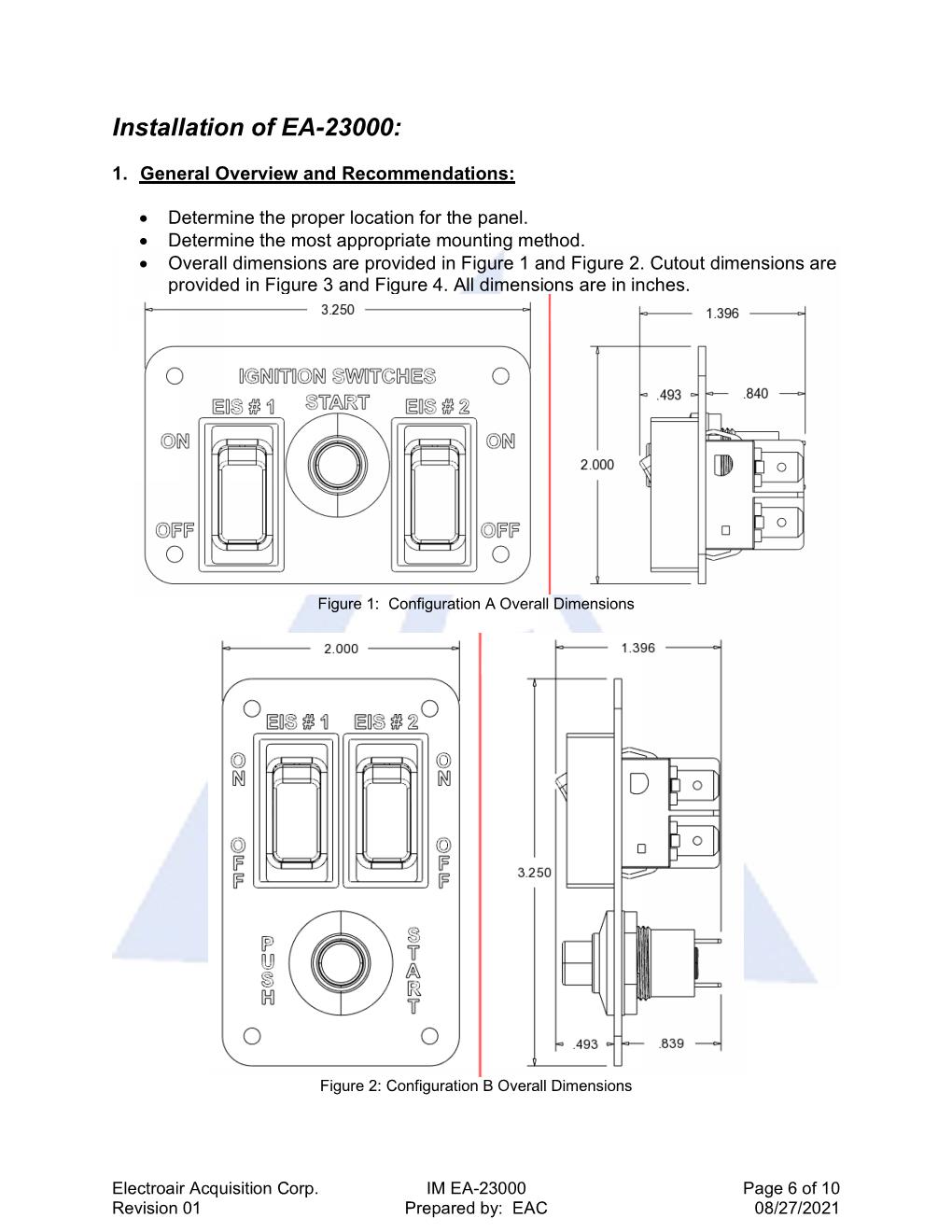

R182 Owner Todd Fuller advised good results after 1-1/2 years of service with electroair's Electronic Ignition system including easier starts, variable spark ignition benefits, slightly cooler CHTs and no more dual magneto to maintain or worry about.
Installation Manual and Approval docs attached.
