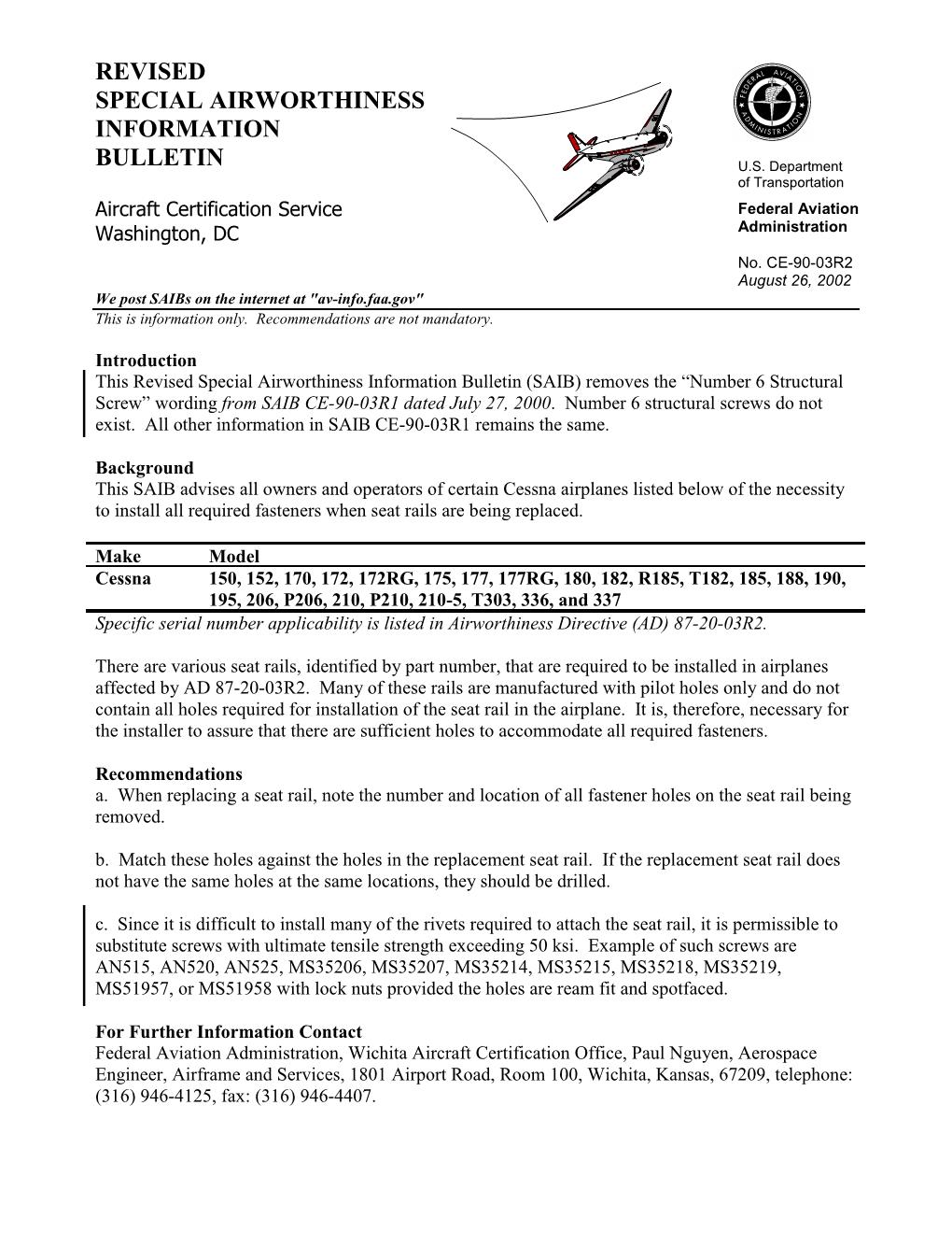

Reference FAA & McFarlane seat rail replacement docs
FAA SeatRail doc ce-90-03r2.jpg (201.6 KiB) Viewed 458 times
