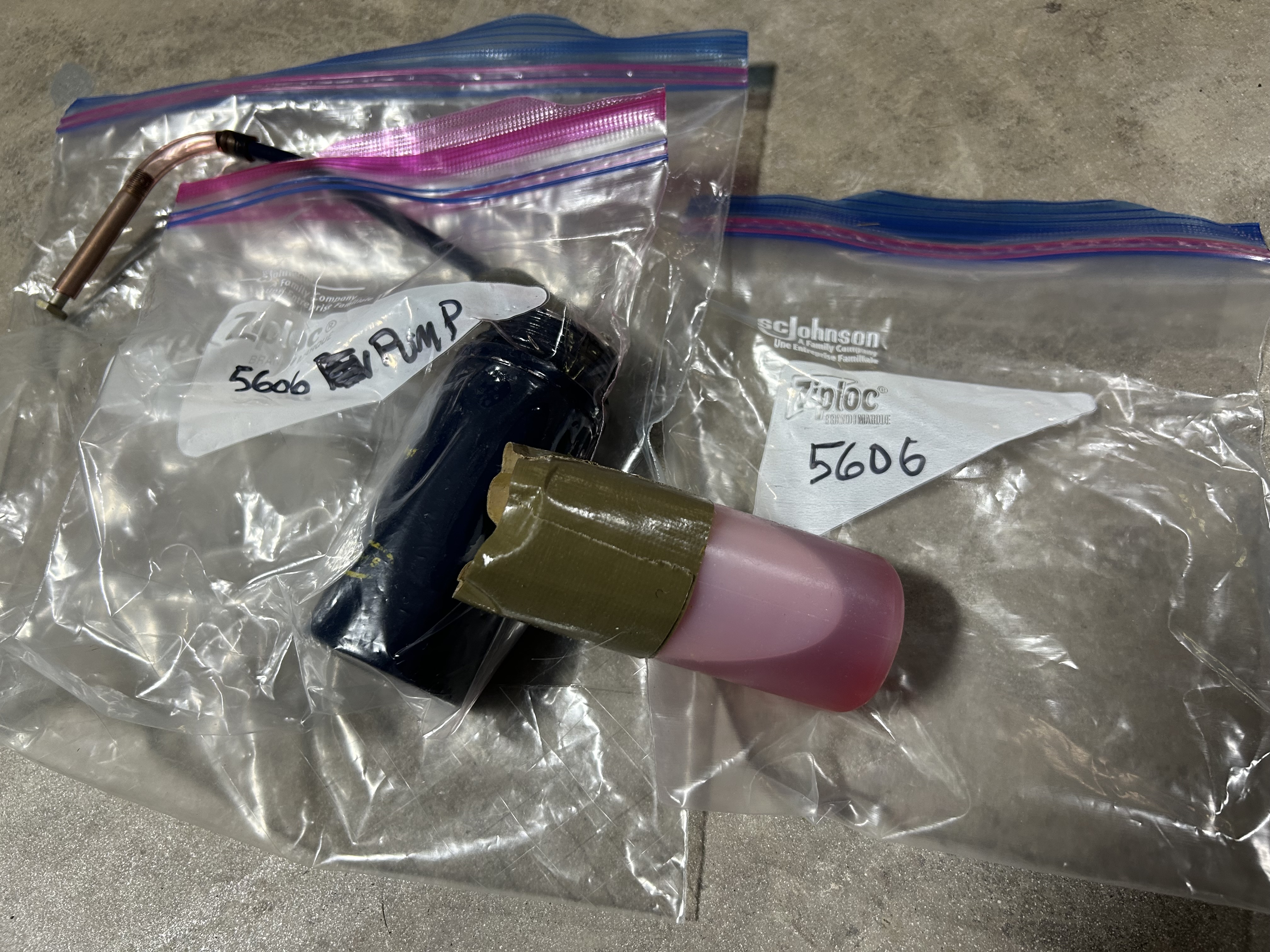

Matt - We carry a small quantity of 5606 hydraulic fluid in a container that can be added to a small hand pump per the below pics. Checking hydraulic fluid level is a preflight item worth adding to your checklist. Carrying the fluid can be messy/smelly so we use multiple Ziplocks for best results.
Forwarded your other questions to Paul New and will post his reply.
