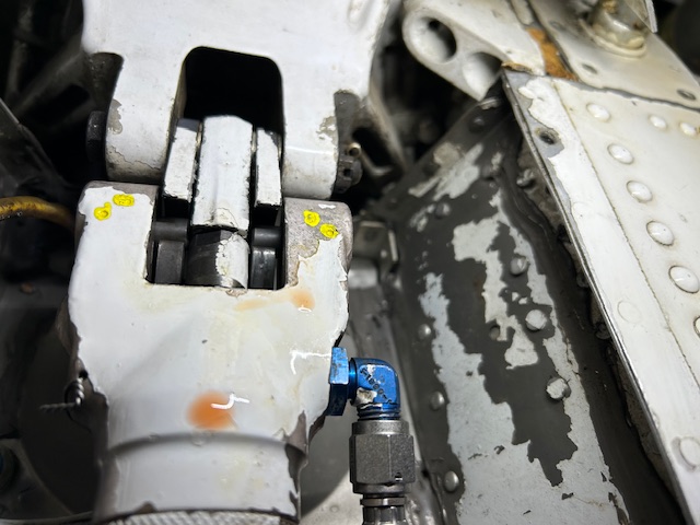

If you see fluid leaks at your NLG actuator that means its time for new O-Rings. See part numbers, O-Rings for each PN, and example of common leak seen.

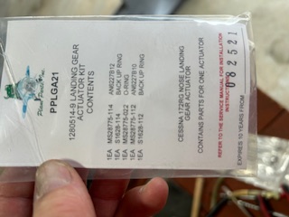

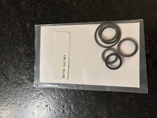

1280514-9 Landing Gear Actuator Seal Kit Contents:
1 EA MS28775-114 AN6227B12
1 EA S1628-114 Back up ring
1EA MS28775-022 O-Ring
1EA MS28775-112 AN6227B10
1EA S1628-112 Back up ring
