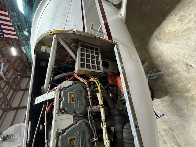

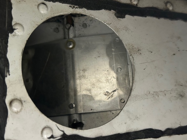

After watching the induction video with Chase Duncan, I got motivated to have a look at mine this morning. The first thing I found, and should have seen long ago, was the missing seal on the back side of the NACA intake. My bearings are also shot on the carb air box butterfly shaft, but the butterfly looks ok from what I can see. My bellows between the carb air box and the carb adaptor looks original (1981).
BTW, I was the one who asked about my carb temp rising when I closed my cowl flaps at the live Ask the A&Ps. There are plenty of possible leak points, as it turns out.
Attached are photos of the NACA duct and the bellows.
Re: Less than ideal Carb Air Box repair
Well the missing seal explains the CAT increase when closing cowl flaps and hopefully motivates others to look at the same. Somehow our airbox details are commonly overlooked at annual inspection so as owner/operators we must check this item.
Chase Duncan mentions the airbox seal material is available at your local auto parts store, but we used 1/2" thickness EPDM foam rubber from McMaster-Carr found at https://www.mcmaster.com/1566N248/ for $58.74
Not surprised your butterfly bushings are also shot, but is surprising your butterfly looks OK. Yes your bellows looks original so is worth closer look to make sure all's good.
