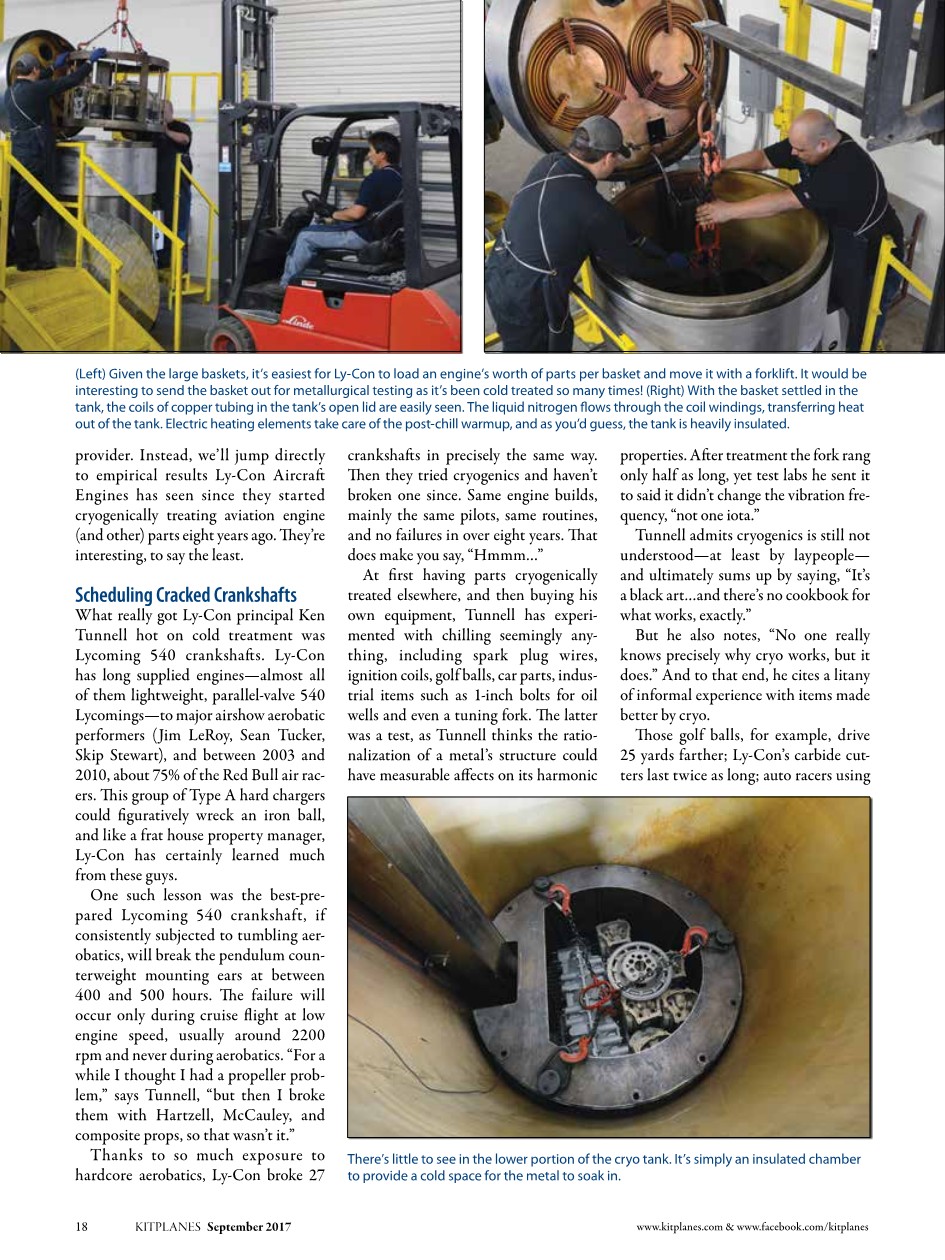

Ly-Con-Cryo (2) Page 001.jpg (284.43 KiB) Viewed 13 times

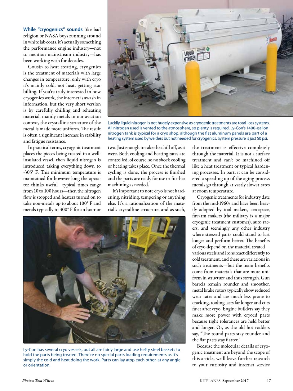

Ly-Con-Cryo (2) Page 002.jpg (356.97 KiB) Viewed 13 times

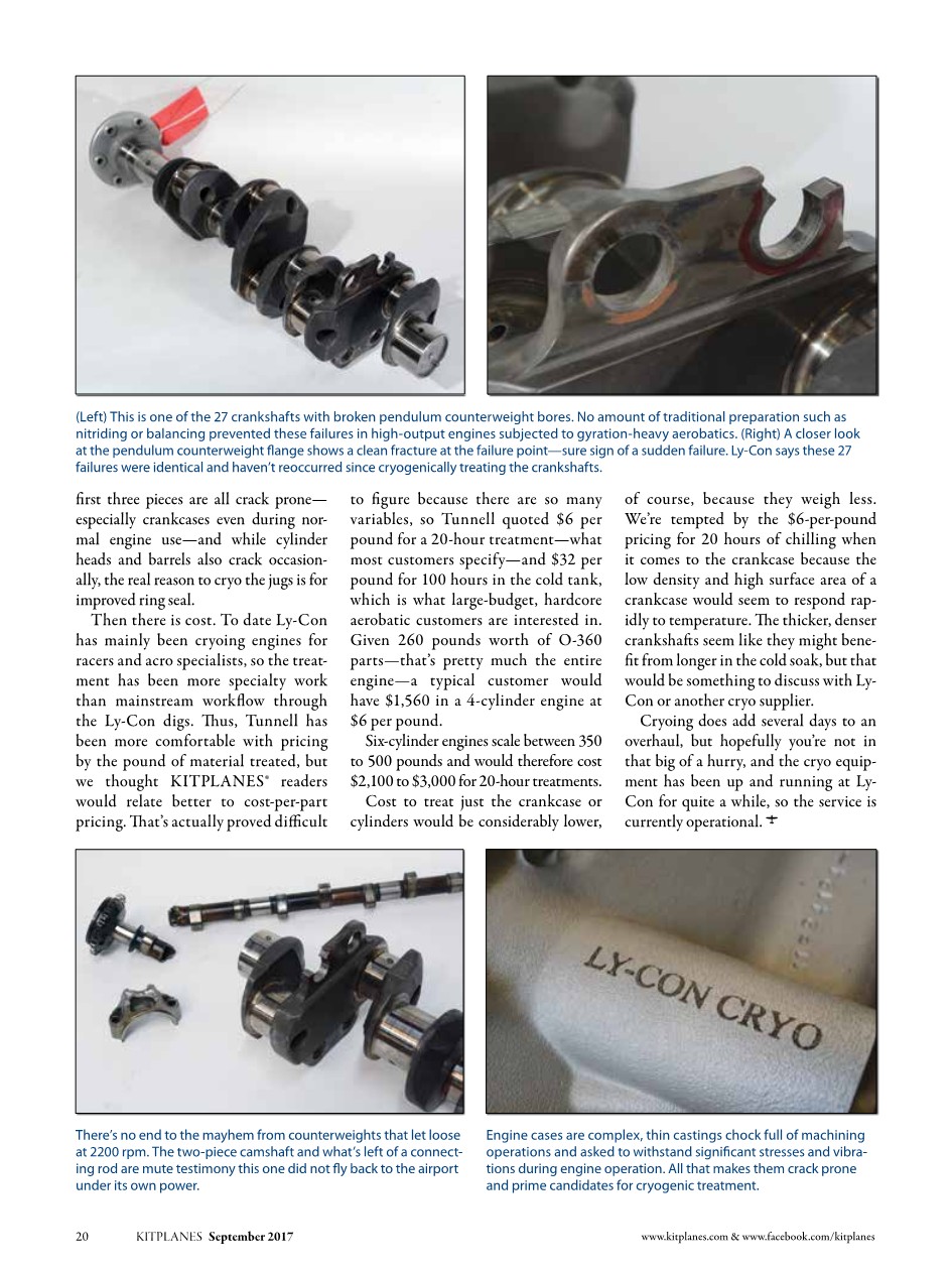

Ly-Con-Cryo (2) Page 003.jpg (375.94 KiB) Viewed 13 times

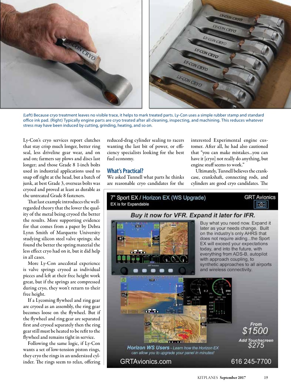

Ly-Con-Cryo (2) Page 004.jpg (327.96 KiB) Viewed 13 times

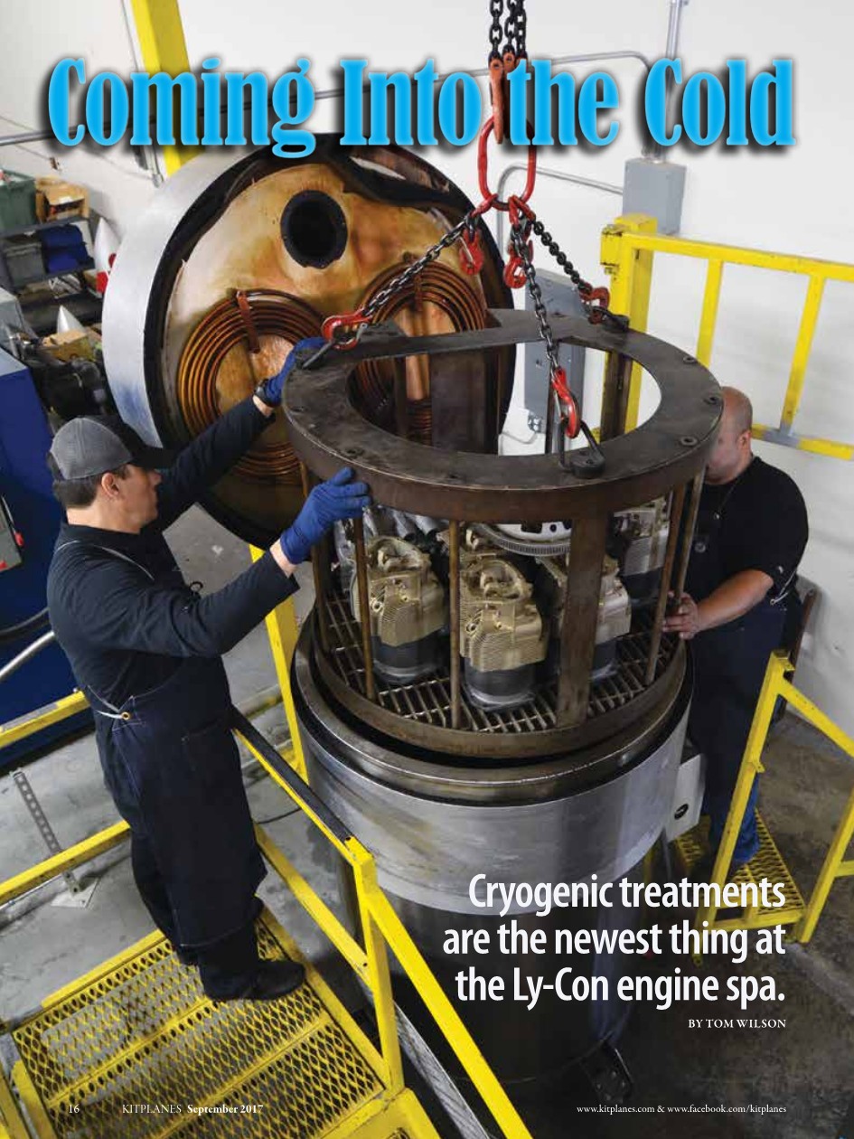

Ly-Con-Cryo (2) Page 005.jpg (296.8 KiB) Viewed 13 times
