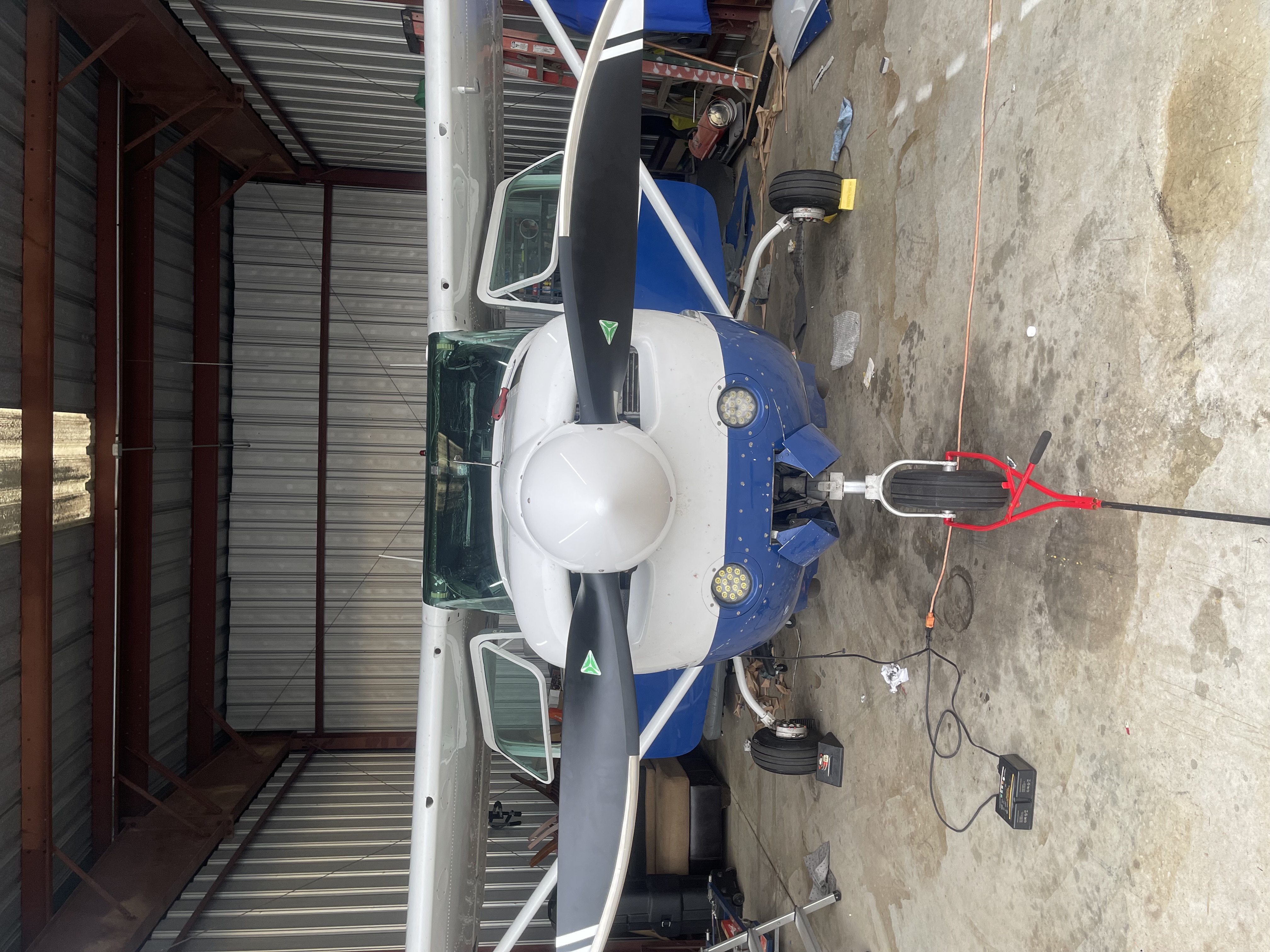

My customer has a 1978 R182 and had a prop strike, so we elected to go from a Hartzell three-blade to an MT two-blade. The ride is definitely smoother, and the plane went from 5-8 slower than book to 5-6 knots faster than book plane. Now, this can't all be given to the MT as I completed a full nose-to-tail flight control re-rig at the same time, but I think the MT definitely helped, and we pulled 30 pounds out of the nose. The 78 models are pretty nose-heavy with the battery up from, and the Hartzell prop was on the order of 15 pounds heavier than stock, so the MT was a nice improvement in flight characteristics. If installed in a TR182, the Hartzell STC calls for a ballast weight to be installed in the tail, and I can't figure out why they didn't call for that for all R182. He would routinely run out of elevator up trim with two people up front, but that is no longer the case.
