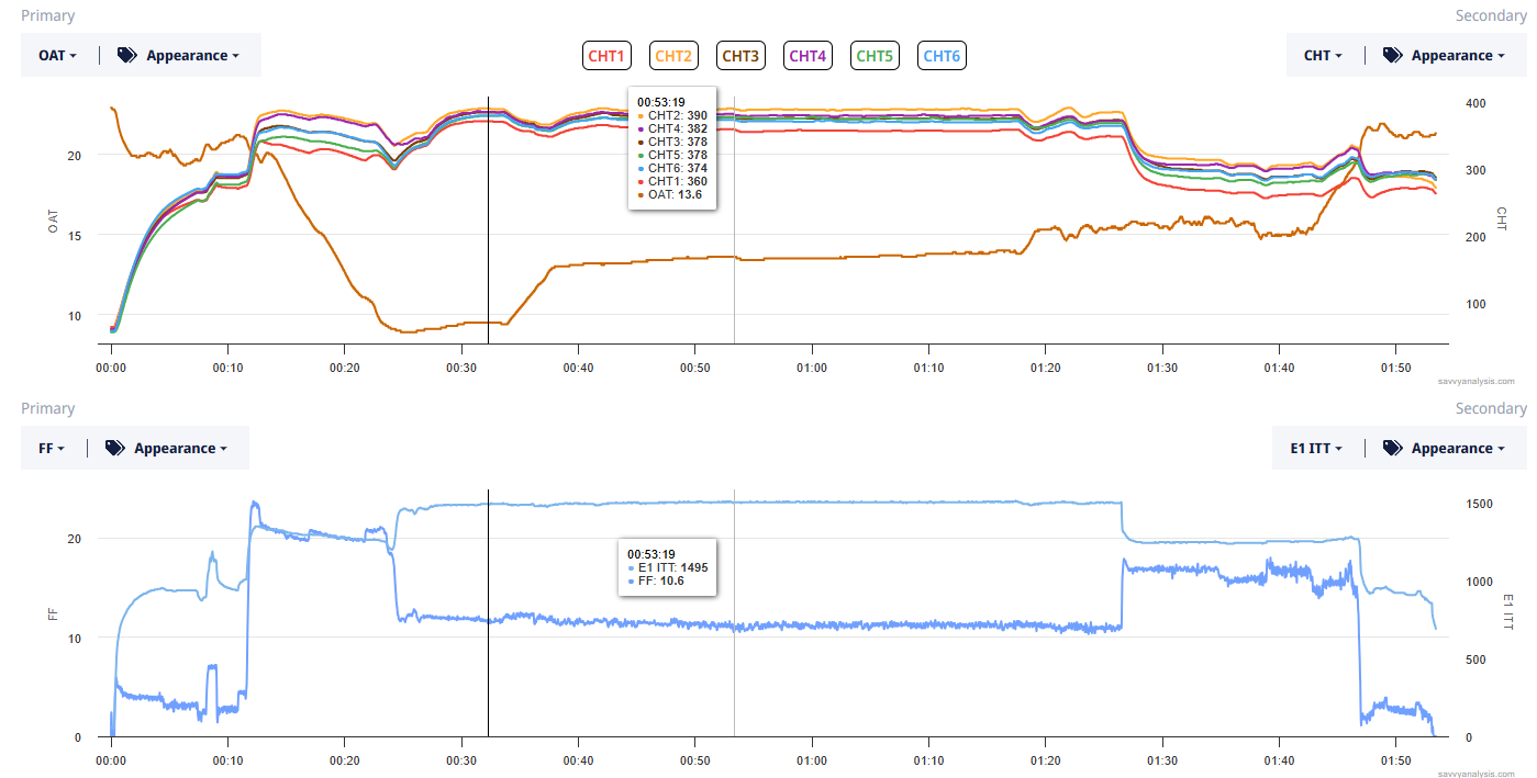

Here is an example flight where I manually leaned to the onset of roughness. I'm always open to an opportunity to learn, and I appreciate the discussion!

Nad, I agree it is sad that data/info is so anemic. But that was the way it was 45 years ago.
POH numbers came from test pilots on brand new aircraft. Endurance is likely from LOP best case. Speed, ROP leaned to best speed.
I’m not advocating lean of peak on carbureted engines, even if our fore fathers did it all the time.
I’m just pointing out the conflict with the certificated data and Lycoming’s bulletin. The same has been pointed out in Piper documents.
On your GAMI test, you didn’t mention what % power setting you were at? The “detonation zone” supposedly doesn’t matter if you are 65% or lower. So why did Mr. Bush think your test point produced risk? At any point the cylinders will have different A/F ratios.
Also, as you pointed out from more recent publications and a lot of GAMI work any setting when less than 65% power is ok. Our POH manual points out a specific, 150 deg point at MAX power cruise, 75%. I haven’t checked but running 50 ROP vs. 150 at any power setting is likely about a ½ gph. Thus, it costs you $5 extra bucks on a 2-hour flight.
Who cares about that? Focus should be on CHT’s.
Generally, I always run around 68-70% power in cruise, managing CHT’s to 390 in the warm months trying to lean for best speed. I bought it to go faster than my Taylorcrafts, fuel burn $’s don’t matter. As I continue to test, I’m trying to find a sweet spot, high MP and continuing to lower RPM which the lower rpm will drop fuel flow way more than a few degrees of EGT and have less wear on the engine while trying to maintain best speed.

Thanks for the reply. The GAMI tests I have done have all been at 60-65% power. So yes I should be able to lean to whatever setting I want hypothetically. But I was just looking for some specific recommendations based on the data I was pulling for my airplane. Even different people at Savvy seemed to have different opinions though. The first guy I talked to about it recommended leaning to the onset of roughness and then enrichening a few turns, which is generally discouraged in most of Savvy's published material. The next guy recommended running 100-150 ROP TIT. No one gave a concrete answer of why they didn't recommend running at peak TIT or as lean as possible though.
I pretty much agree with you on all points, and do focus on CHT's (keeping under 400). However, CHT's can vary significantly depending on cowl flaps, OAT, and headwind vs. Tailwind. My hypothetical concern is not about $$ spent on extra fuel running 100-150 degrees ROP, but trying to limit the chance of sticking valves from lead oxy-bromide buildup.
Mostly I'm curious to see if there is any general consensus out there from anyone with more expertise than me (that is data driven), because the recommendations that I've run across seems so opinion based. So I would welcome some input from Lycoming. Thanks again.
