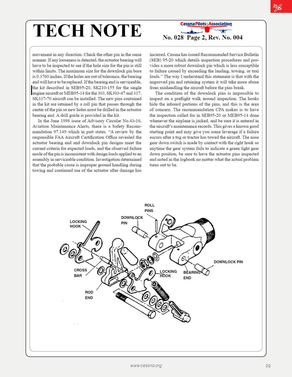

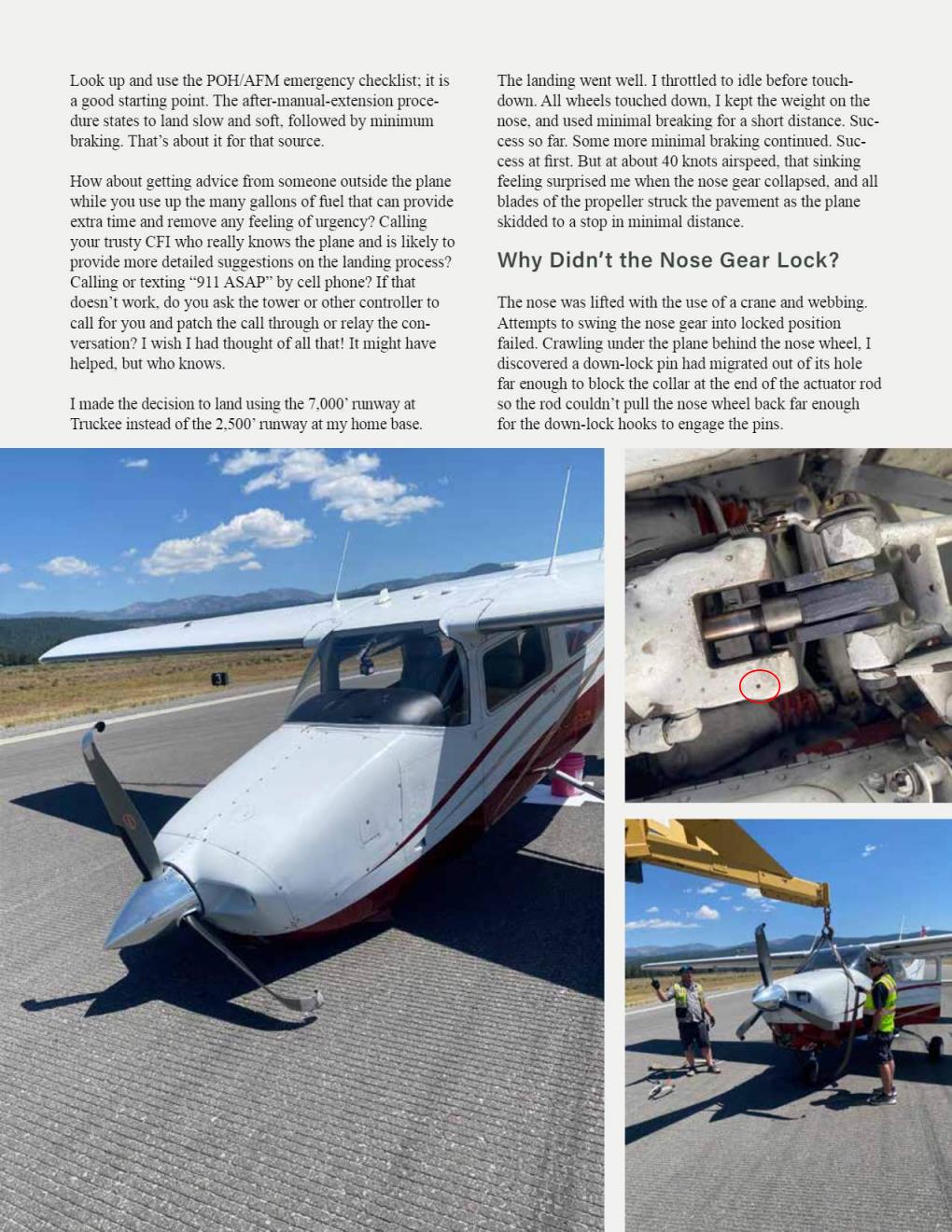

See highlights & comments on p.3. If your airplane has not had SEB95-20 performed then
p.3 is key information. Keeping in mind the late model C210 NLG actuator assemblies
are identical to the R/TR182 - this is confirmed in the Effectivity list on P1&2 of the SB.
