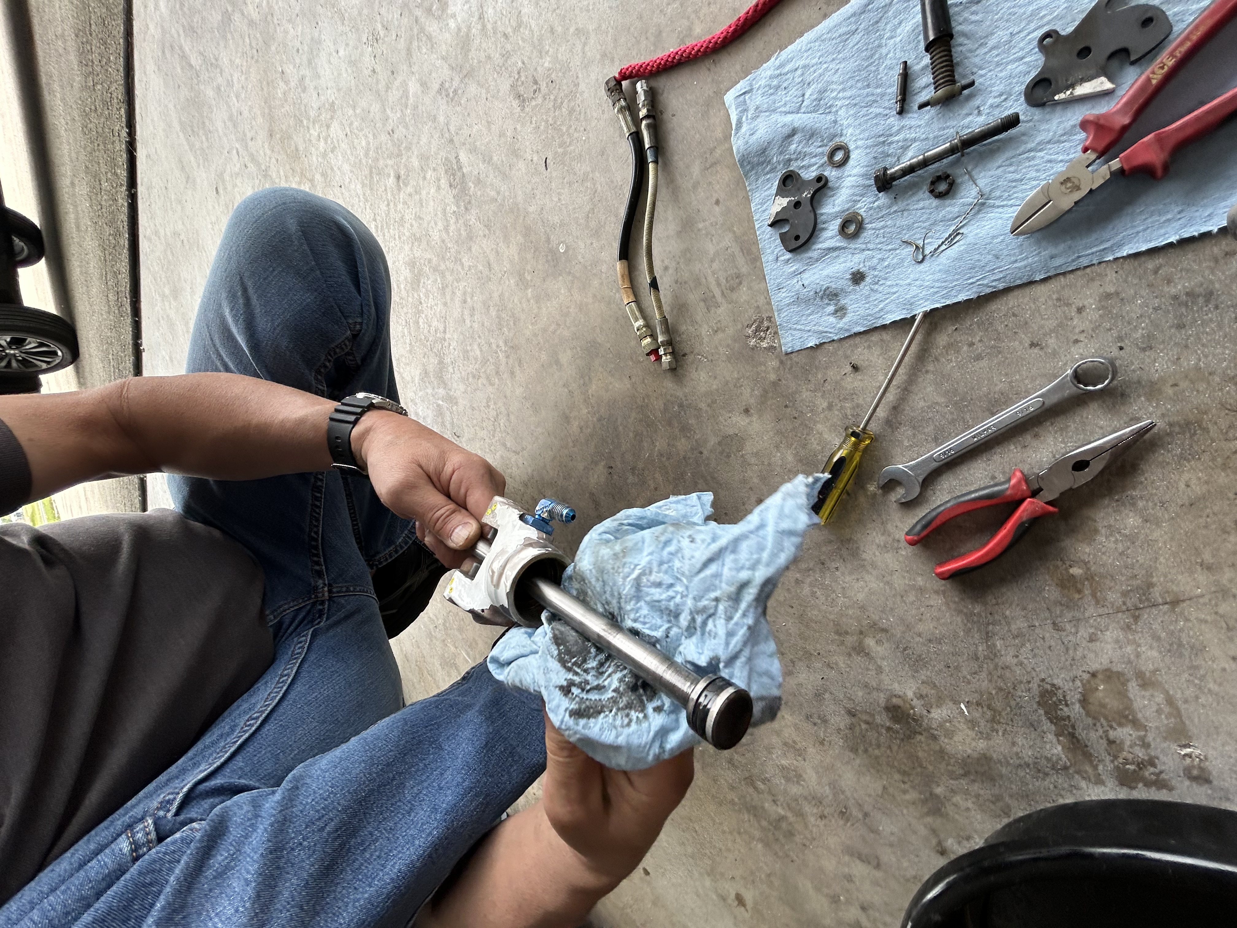

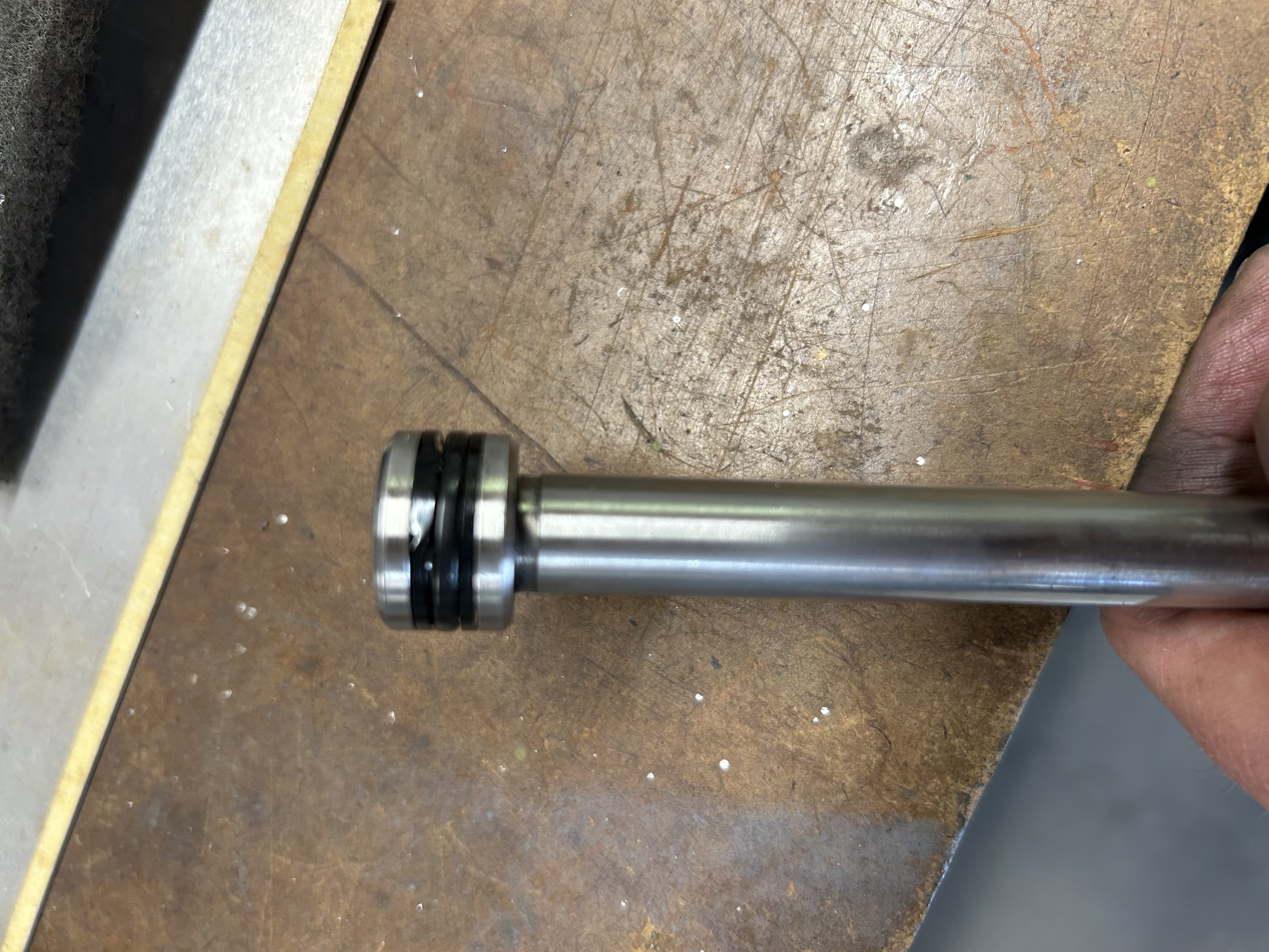

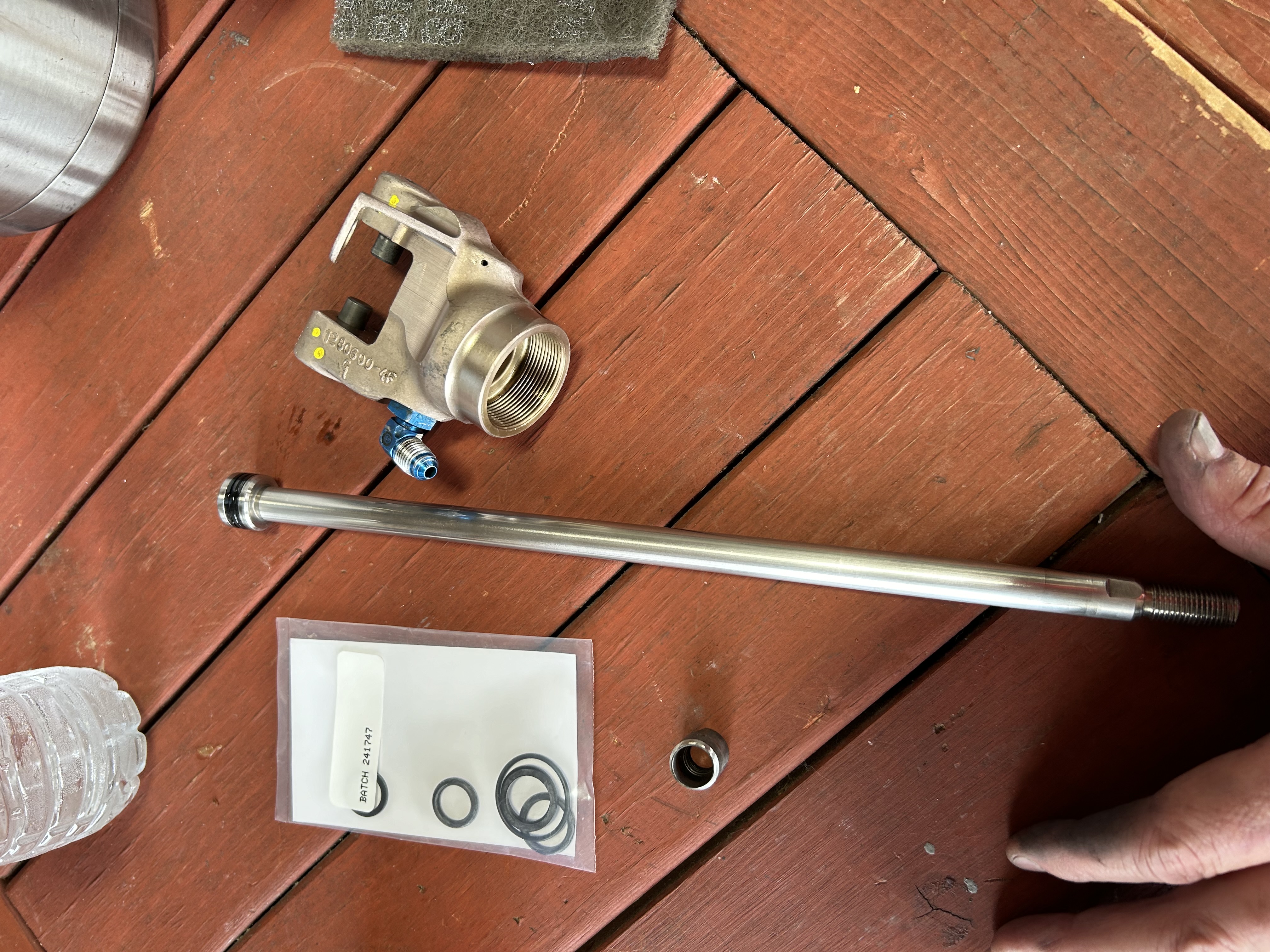

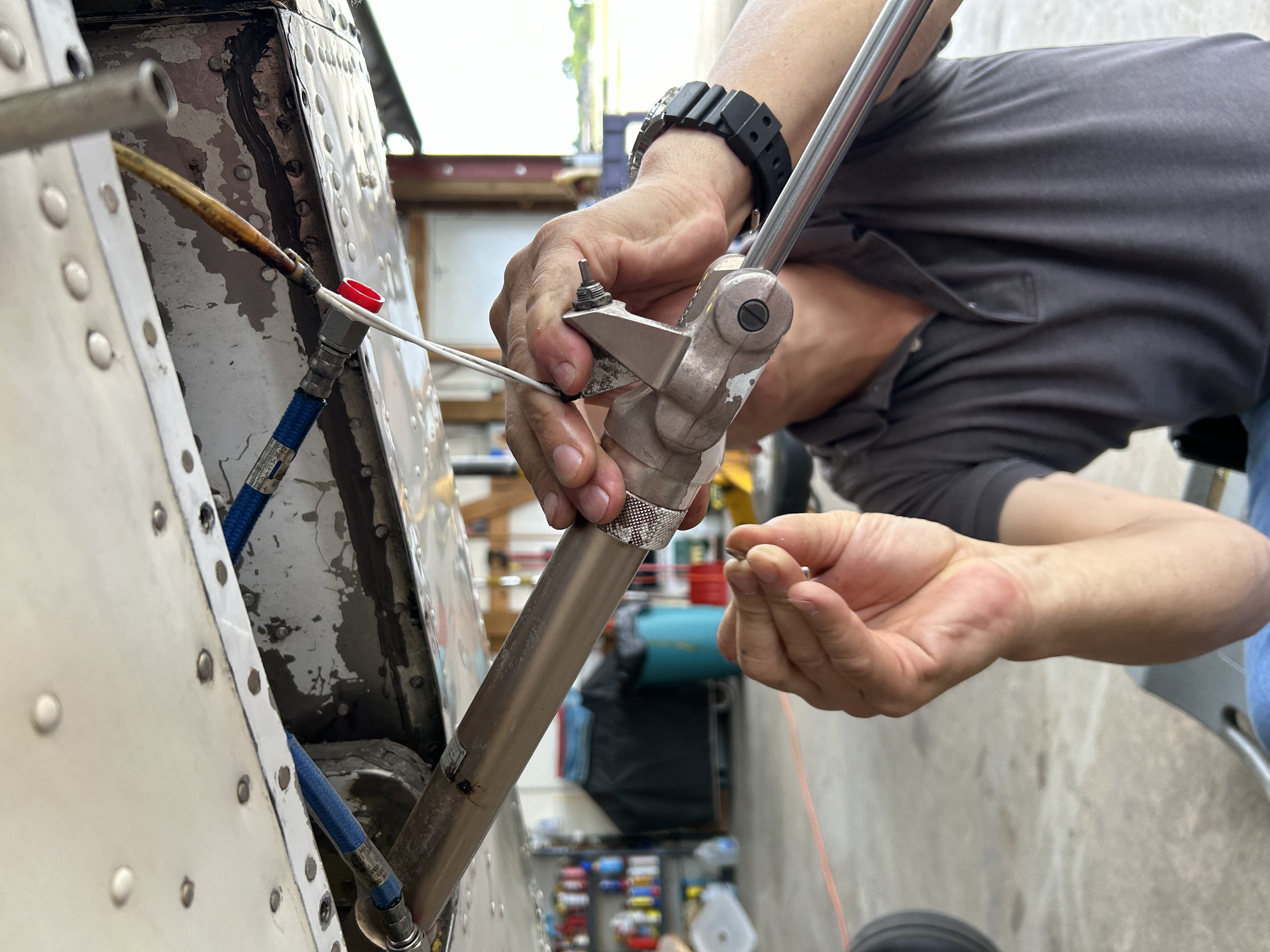

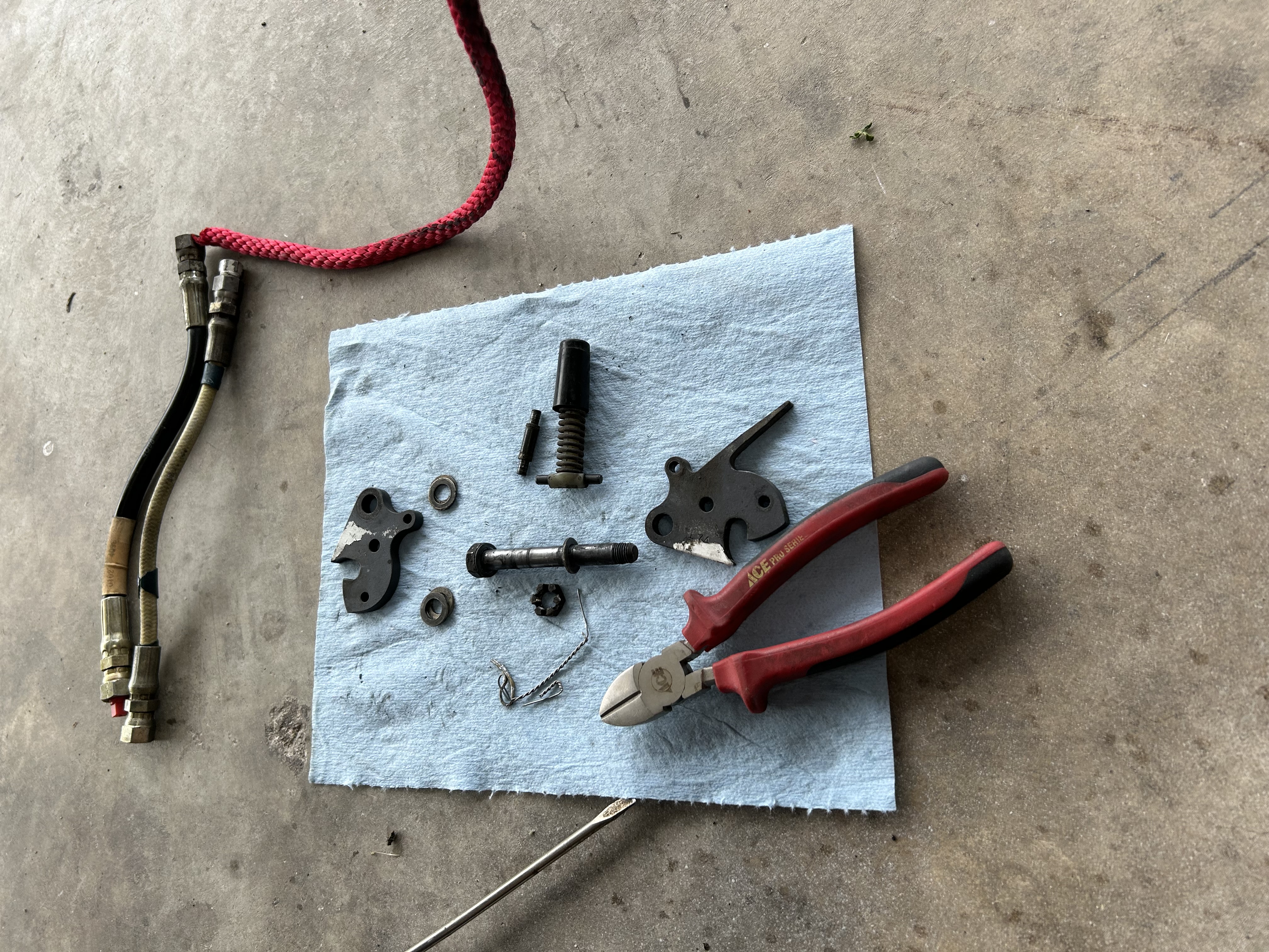

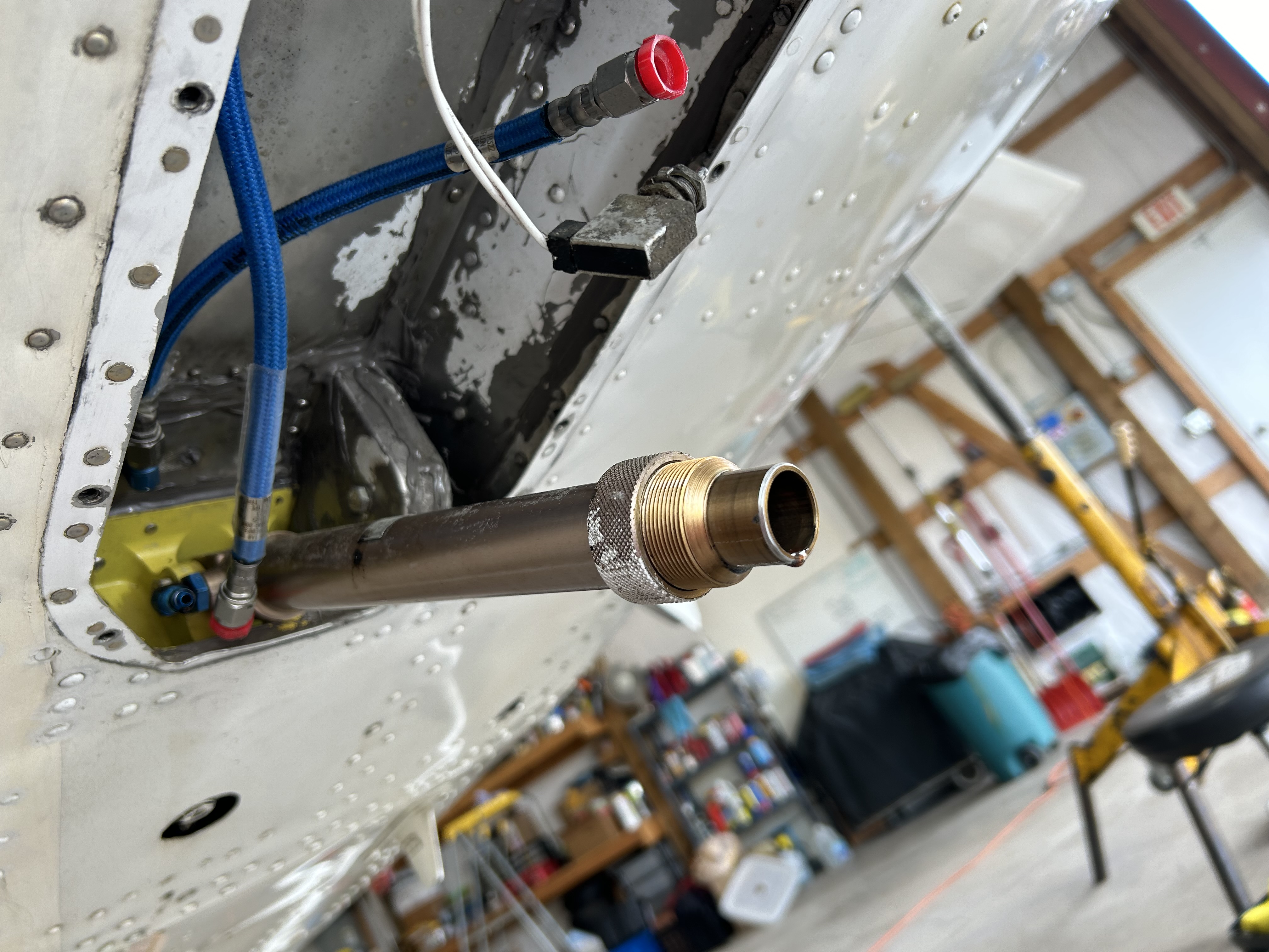

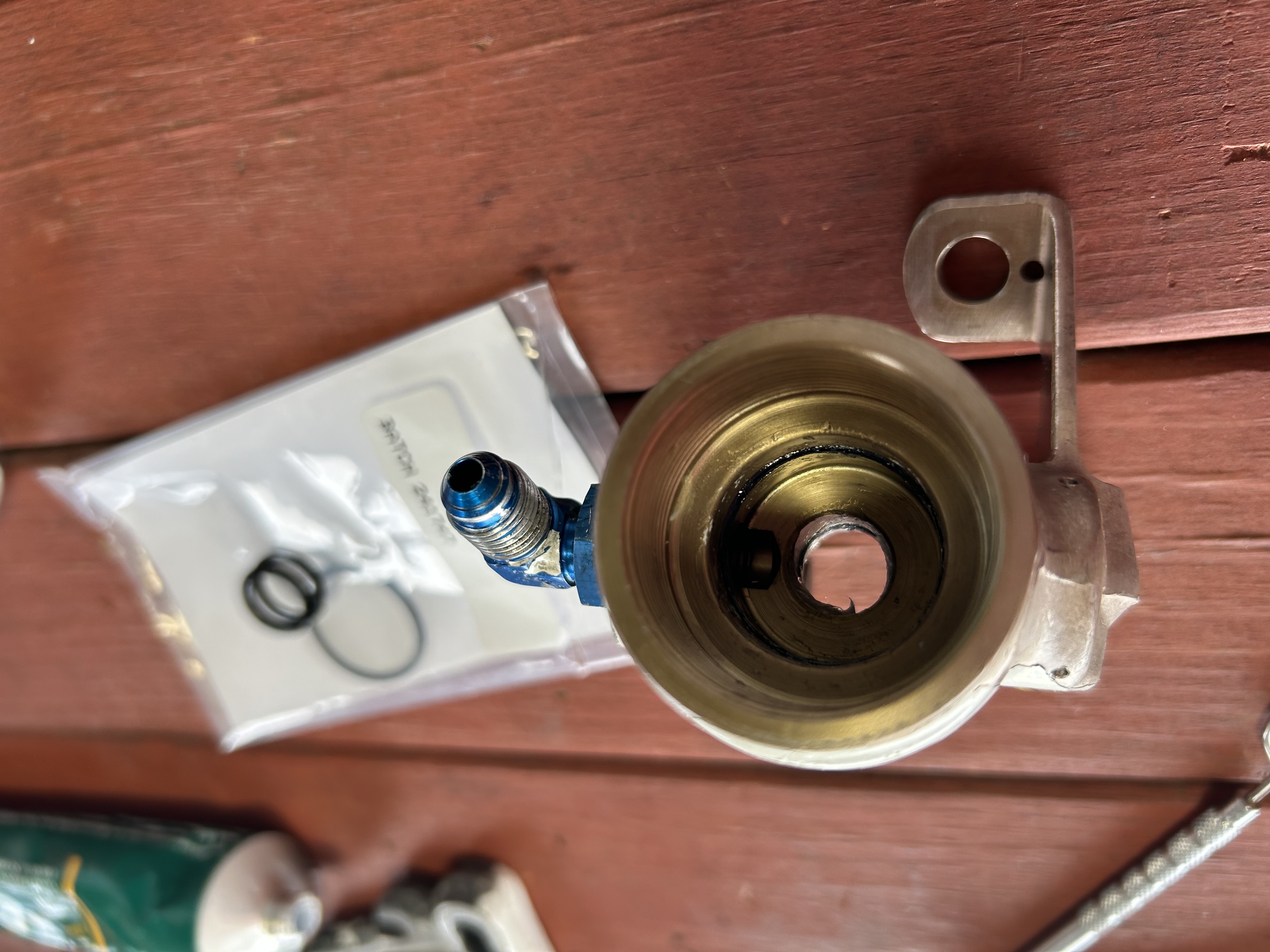

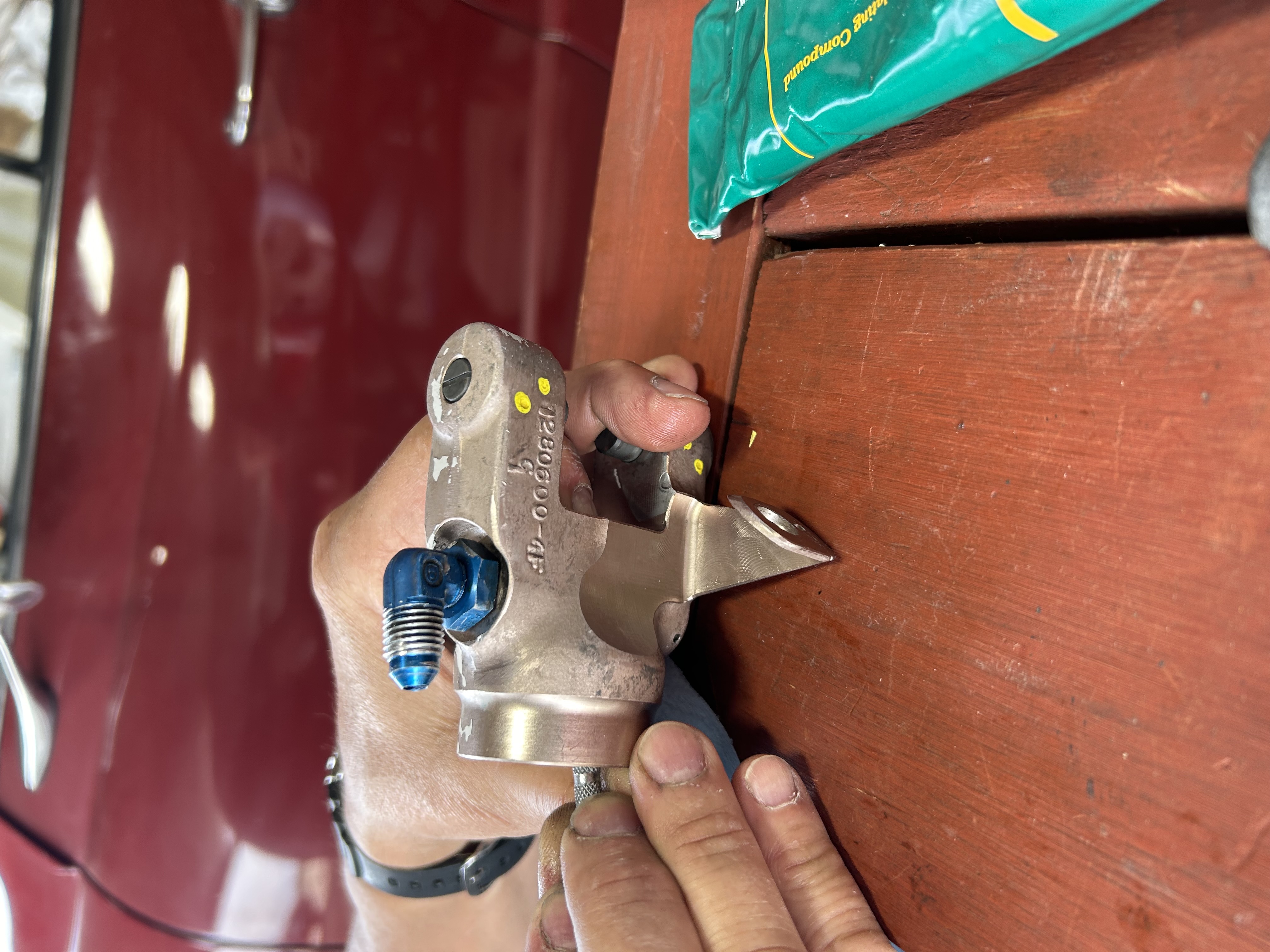

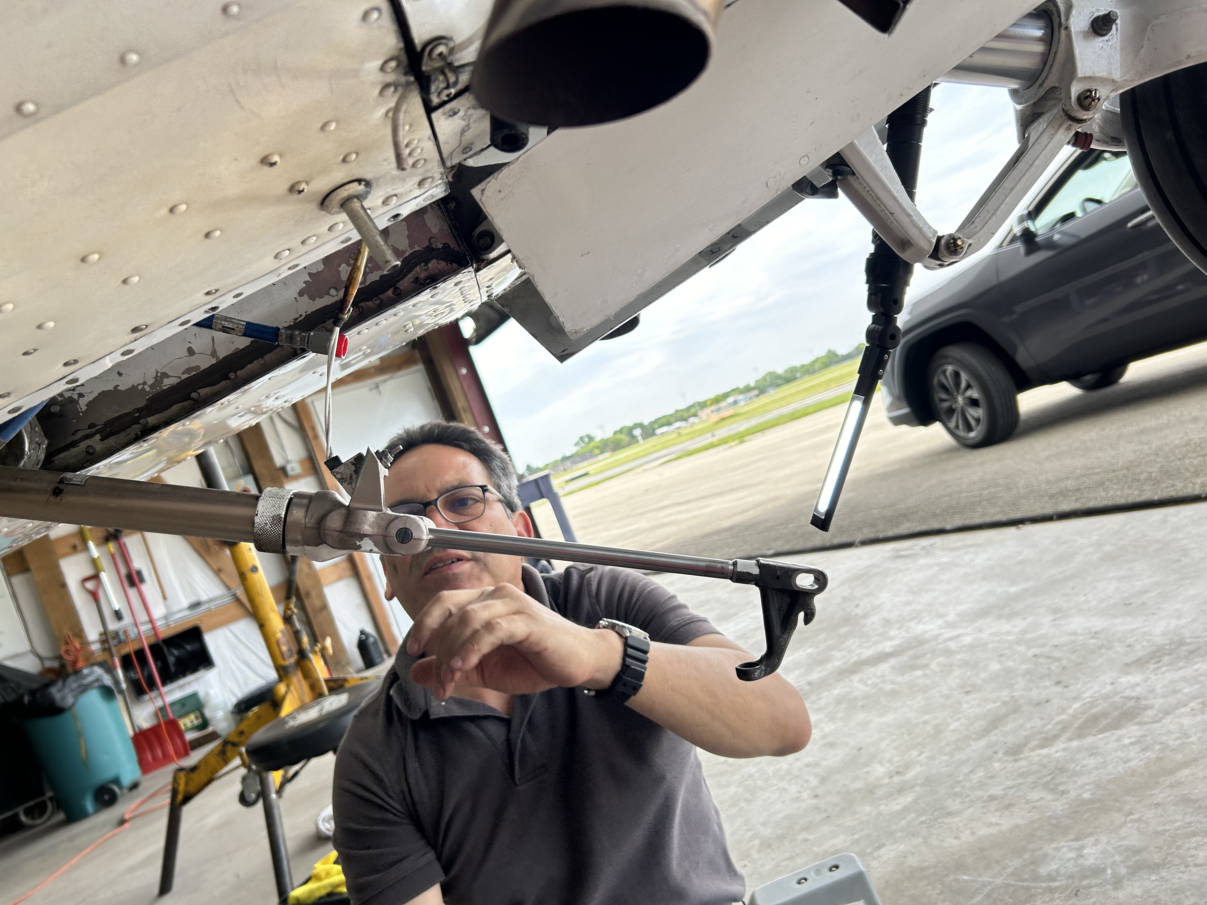

See pics of NLG actuator overhaul with new o rings.
Note the old hoses with peeling plastic and the new blue beaded hoses.
below
