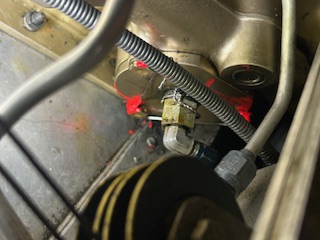

McFarlane's replacement brake swivel fitting is there PN MC1280111-1 https://www.mcfarlaneaviation.com/produ ... x=1&page=1
The fitting is somewhat wet and there's a small amount of hydraulic fluid seen below the fitting.
Look closely at the actuator cover and you'll see drilled head bolts, safety wire, per SNL86-49 viewtopic.php?t=202 We added torque seal for ease of inspection.
