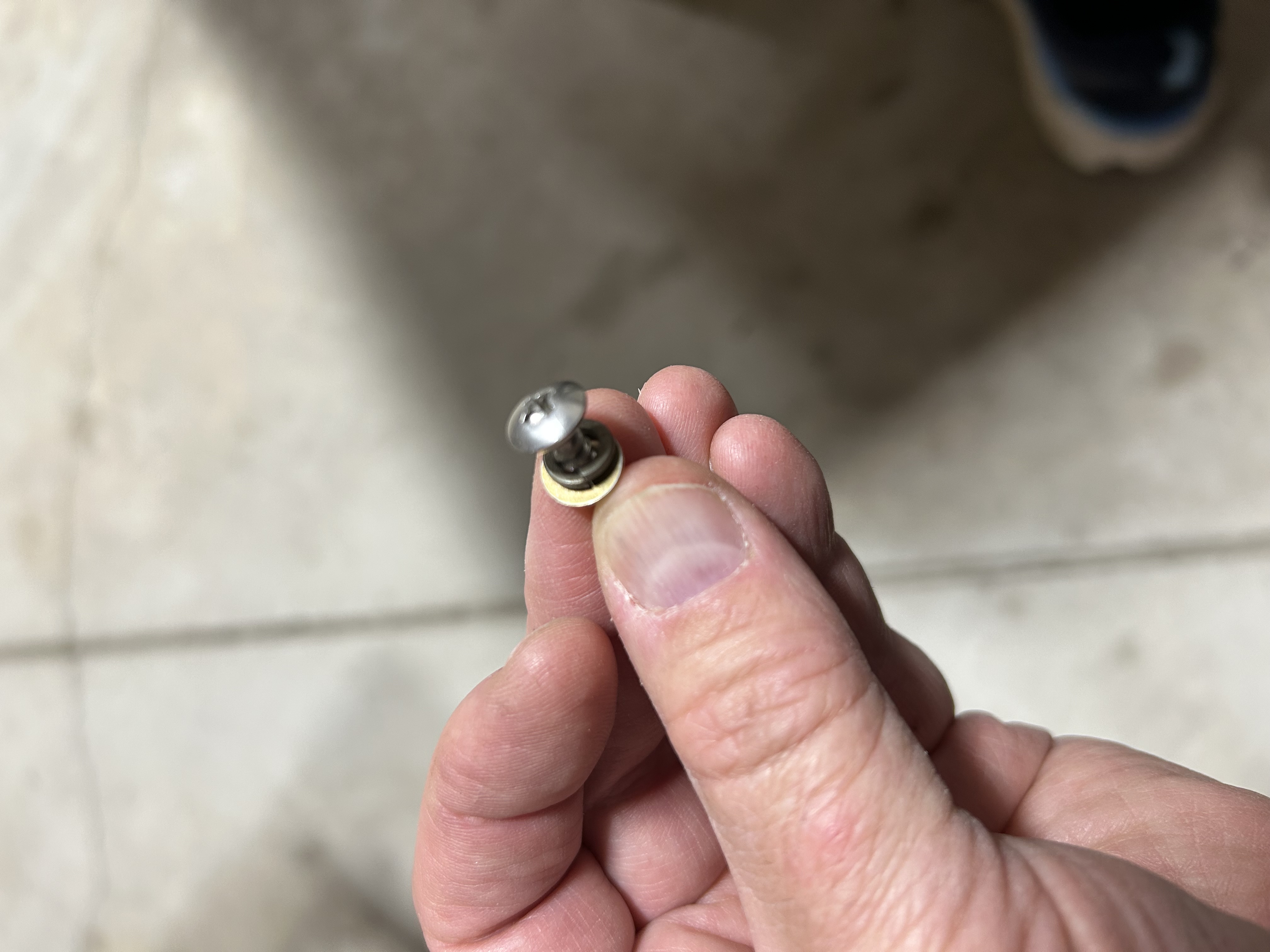

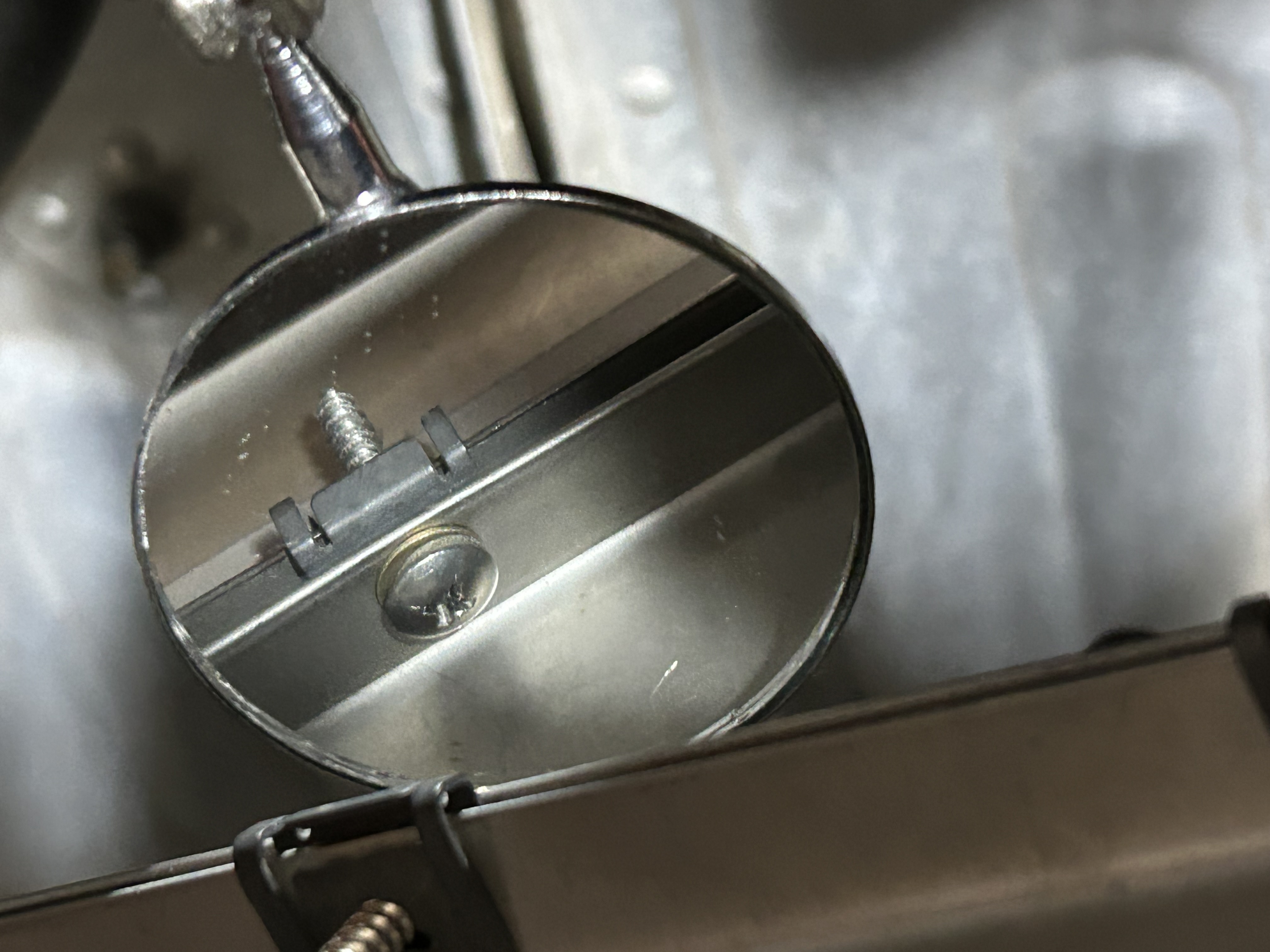

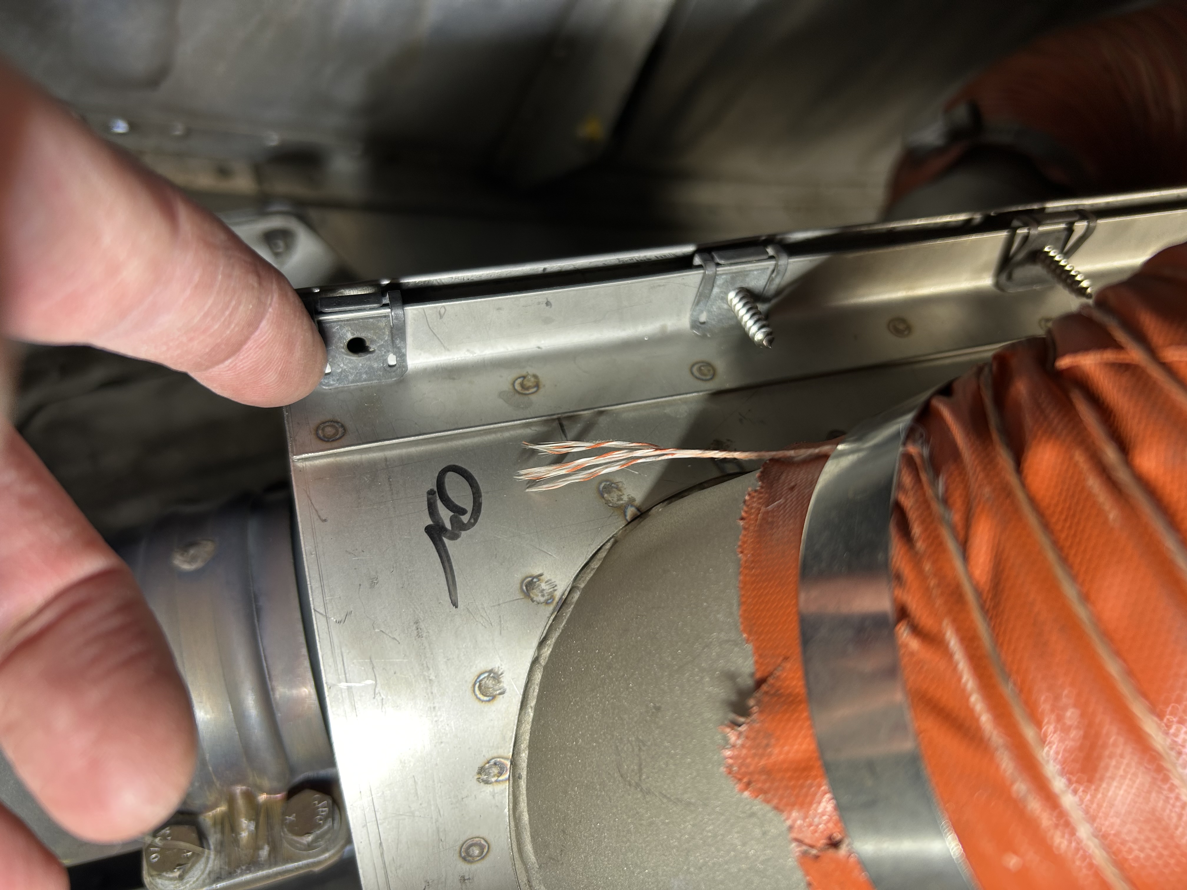

At our 25hr oil change we noticed missing screw(pic1), so checked screw torques to find all were loose. Couldn’t find a torque figure for #8 sheet metal screws in Lycoming’s torque chart. IA said they should tight enough not to back out(hand tight). Don't overtighten - remember there's lots of thermal expansion/contraction going on here, so I'm calling it just very snug. Added split & flat washers(pic2&3) to all screws which should stop them from backing out/loosening.
