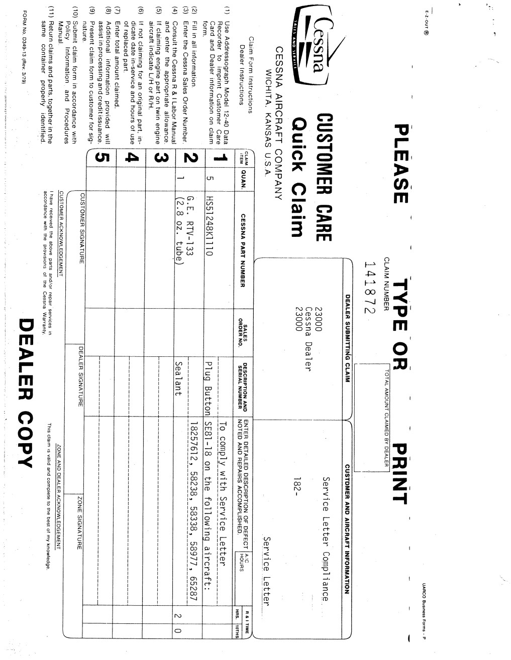

SE81-18 NLG Tunnel Access Hole Plug Button Page 005.jpg (161.97 KiB) Viewed 343 times

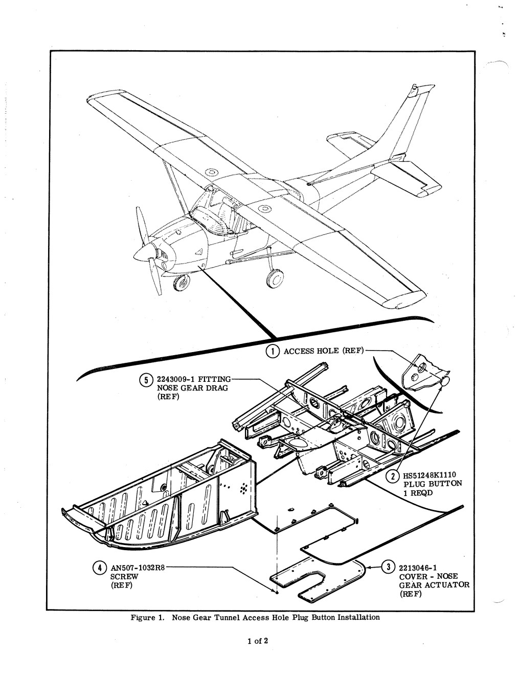

SE81-18 NLG Tunnel Access Hole Plug Button Page 007.jpg (180.93 KiB) Viewed 343 times
