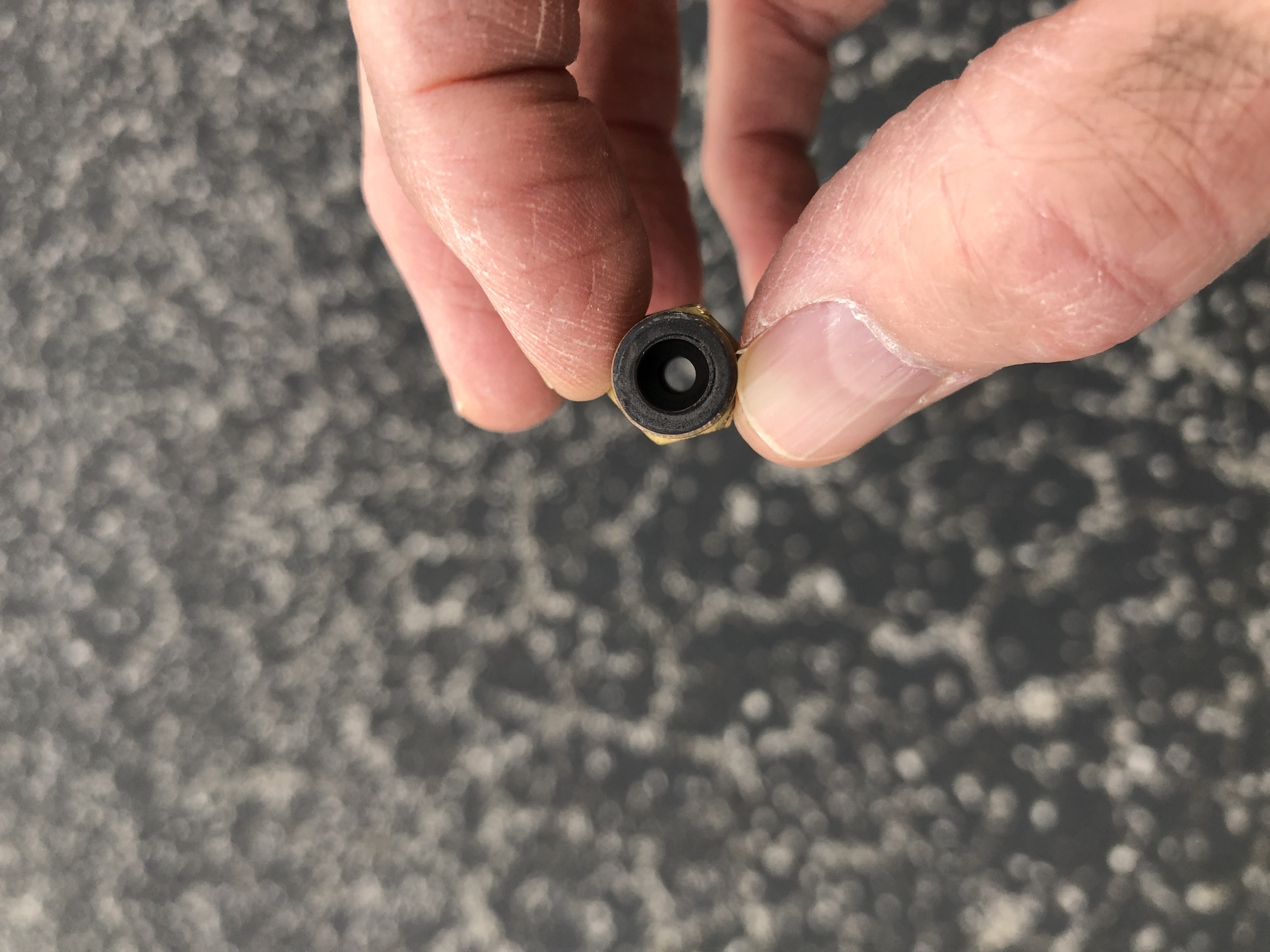

My starting issues are now resolved and it was a weird one. The center jet for the #3 primer nozzle went AWOL. Only the back four cylinders have primer nozzles. #3 was getting most of the fuel from primer strokes flooding it badly while the other three were probably under primed. We don't know where the jet got off to but it's not in the cylinder.
Here is the faulty nozzle:
and the photo here is what it should look like: https://www.aircraftspruce.com/catalog/ ... 4022-1.php
Re: Starting issues
Good catch! Yes missing or broken or cracked primer lines can cause vibration at start as well.
This also makes the case to look for induction system leaks and to check torques on intake flange bolts any of which could contribute to vibration.
