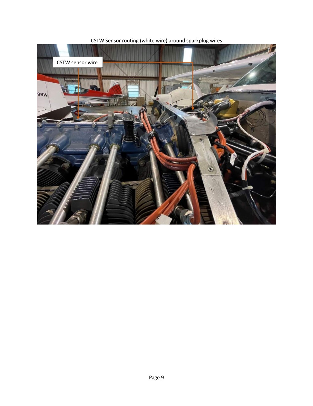

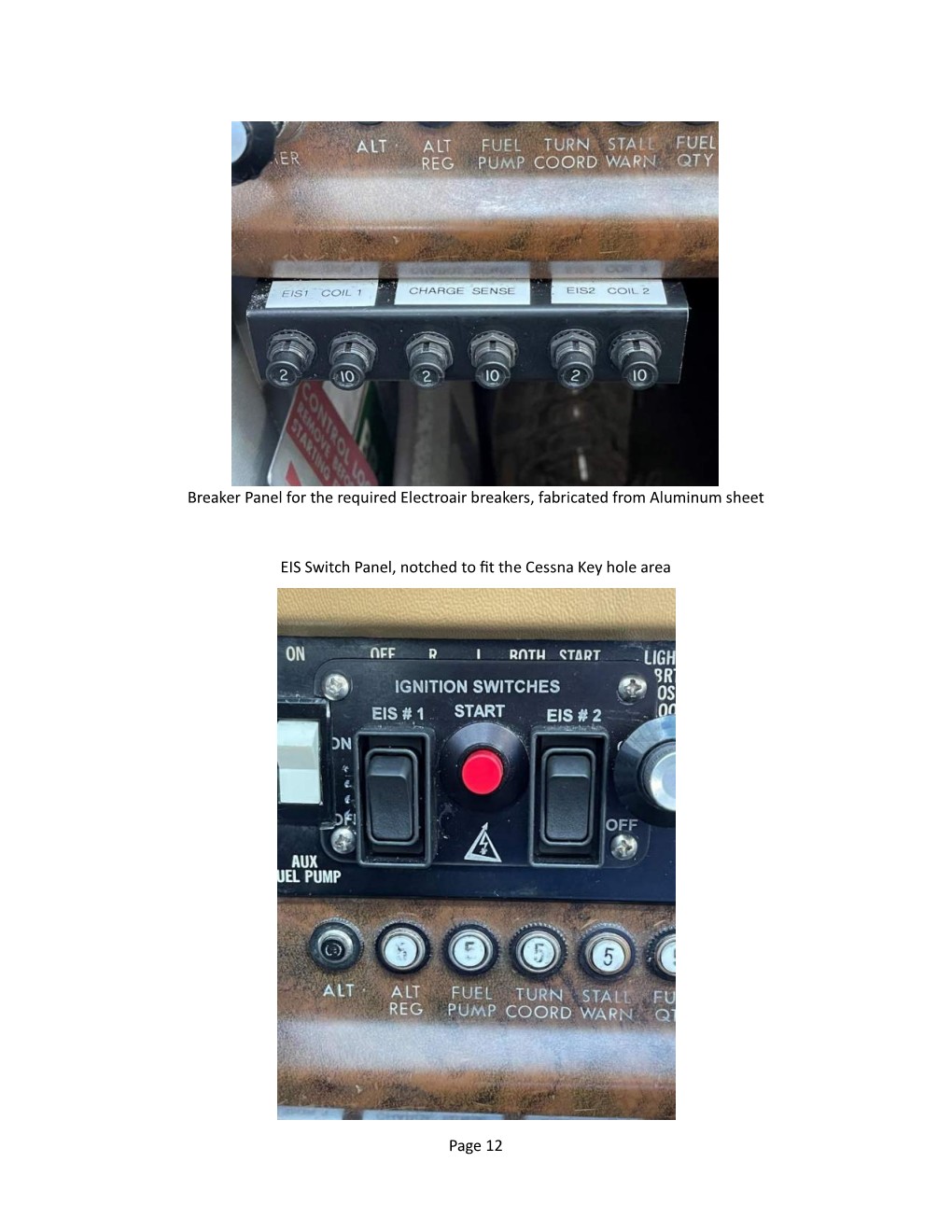

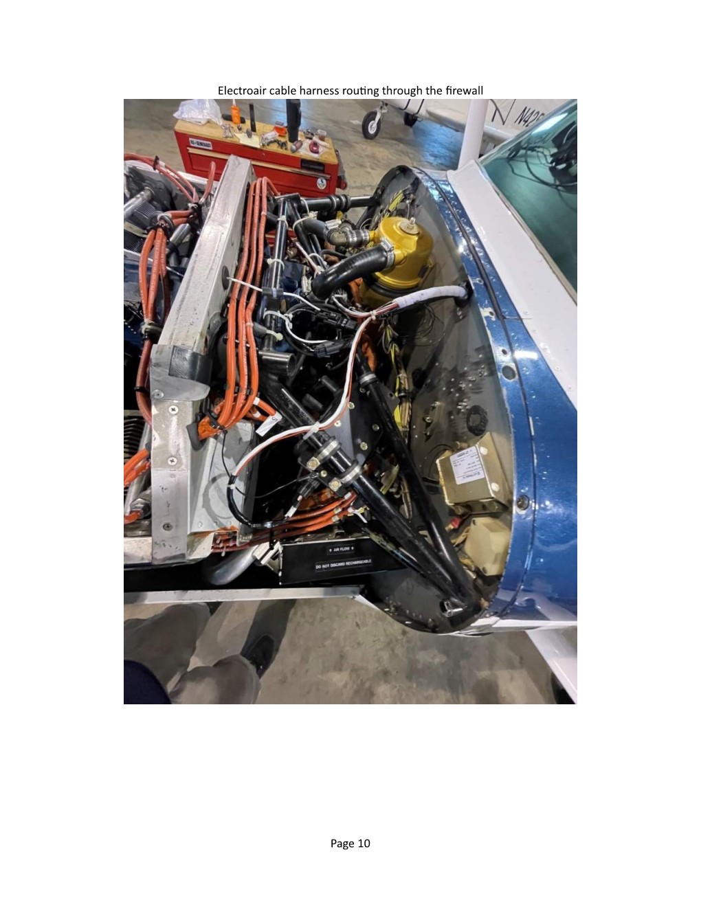

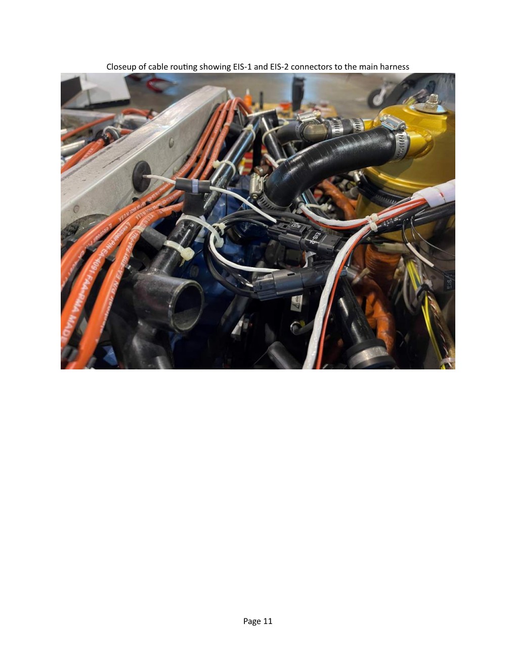

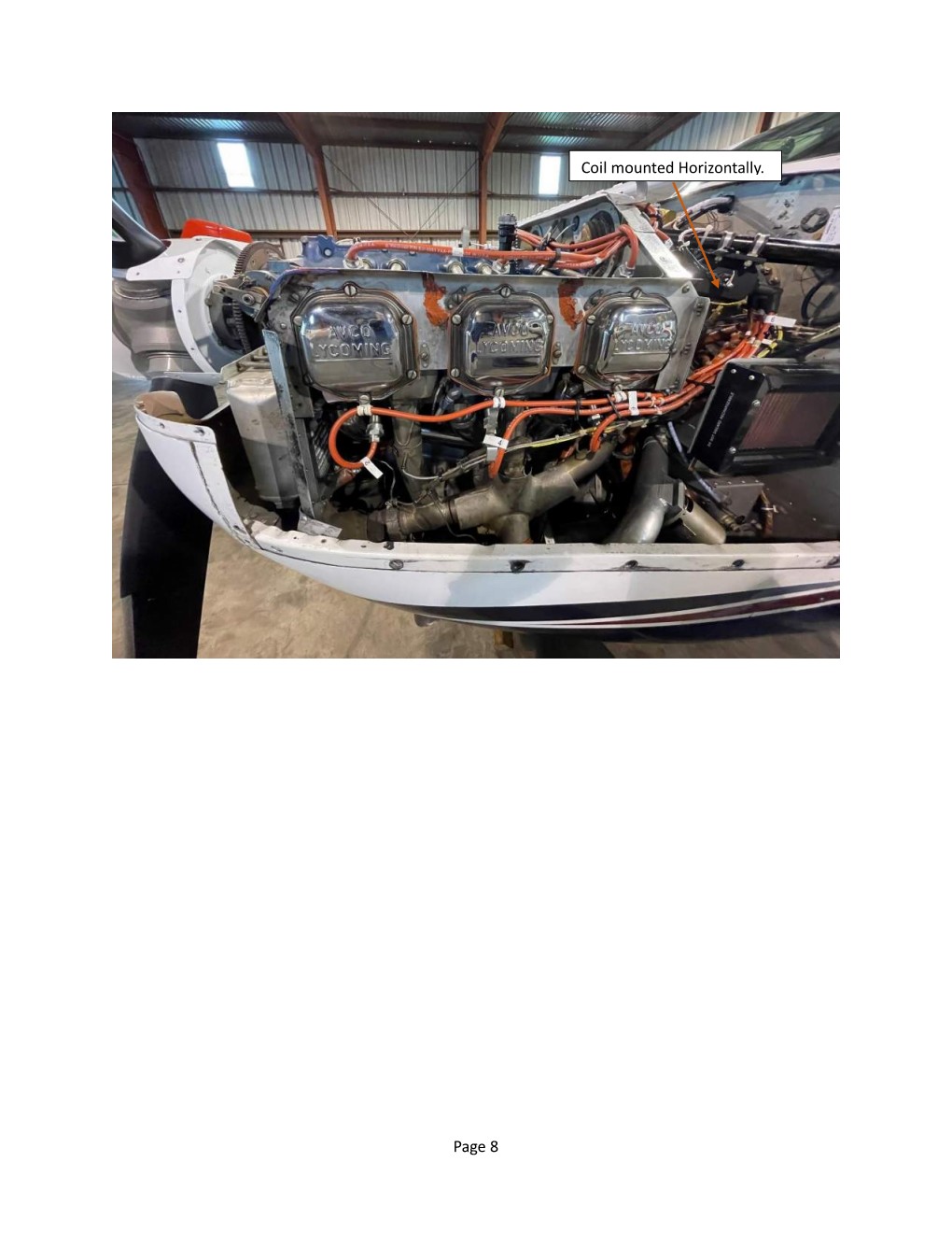

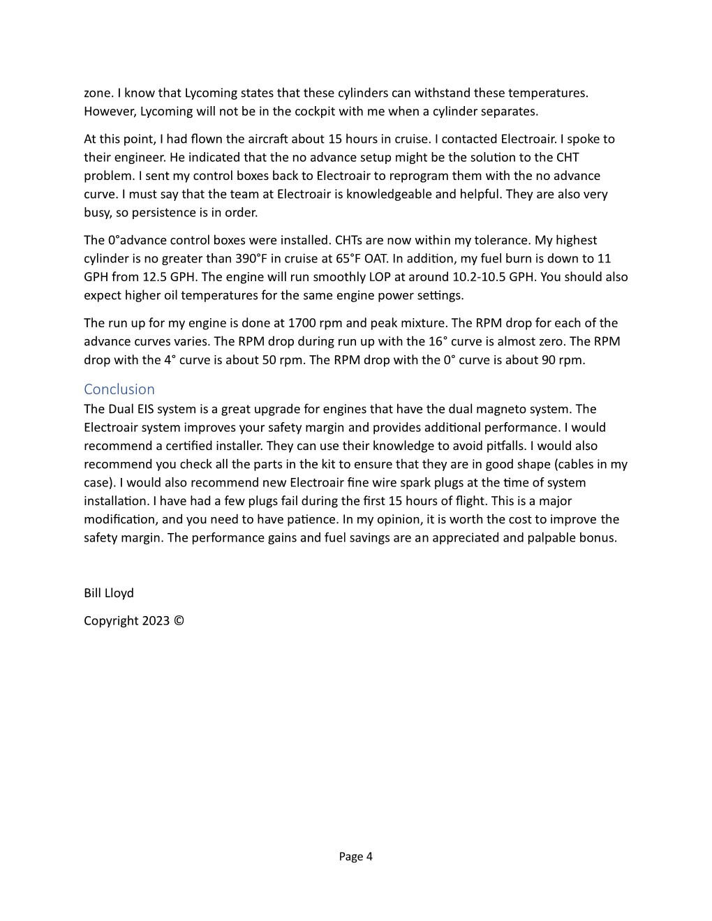

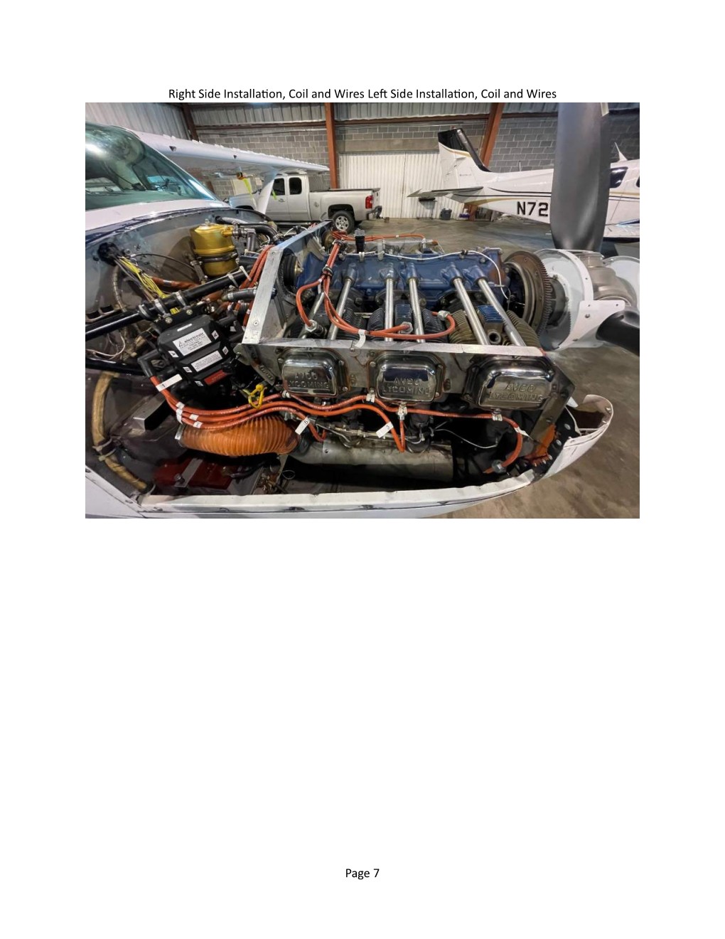

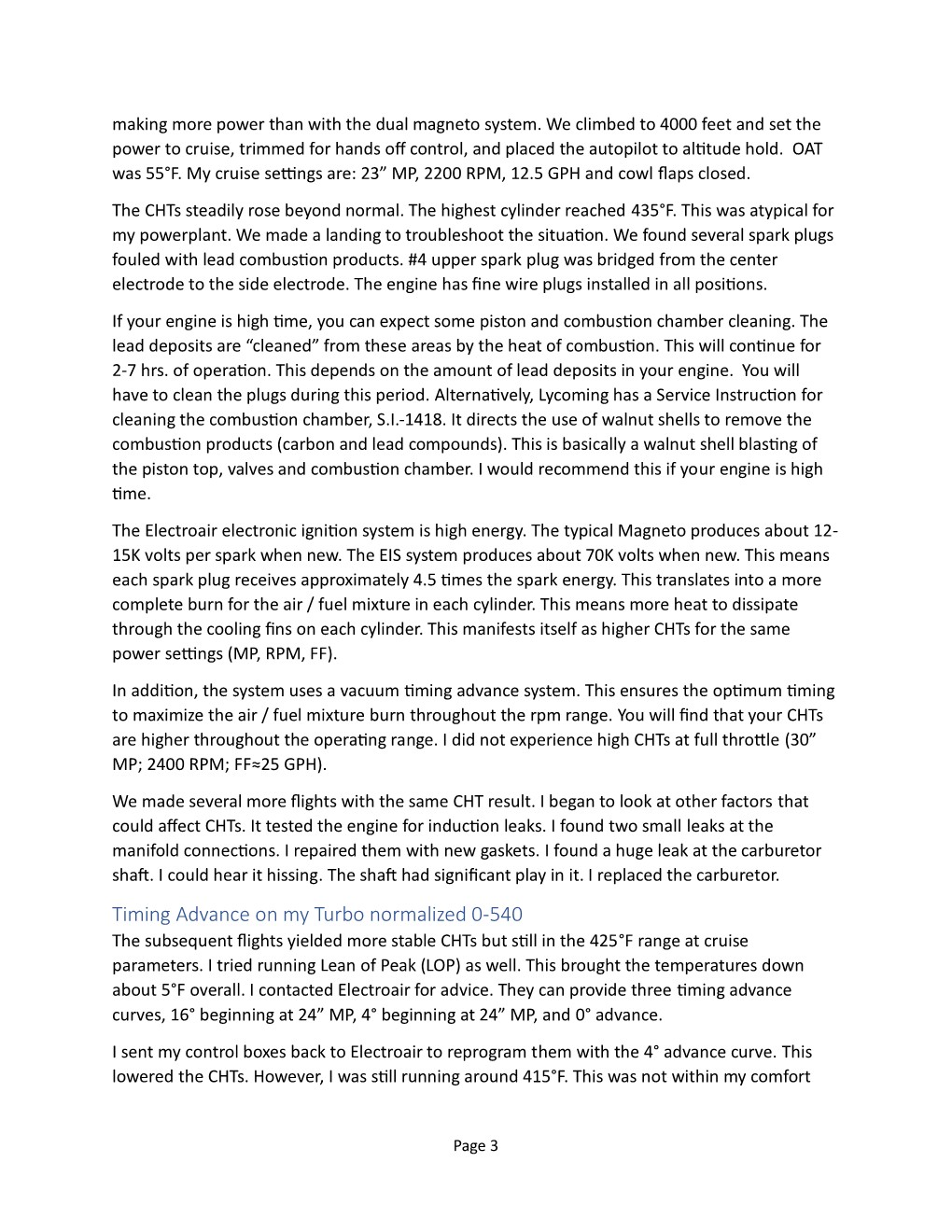

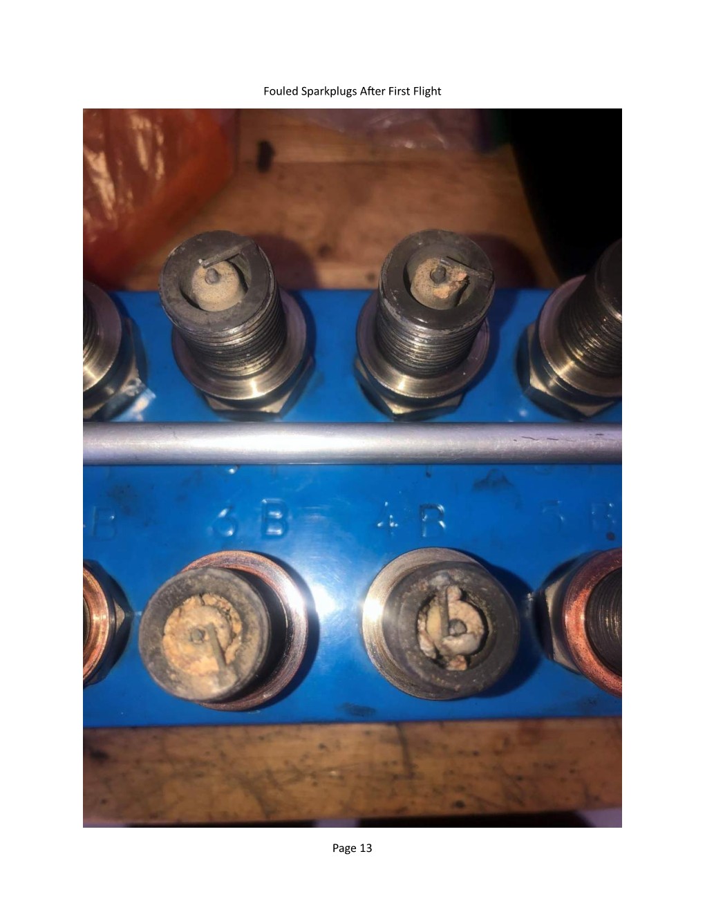

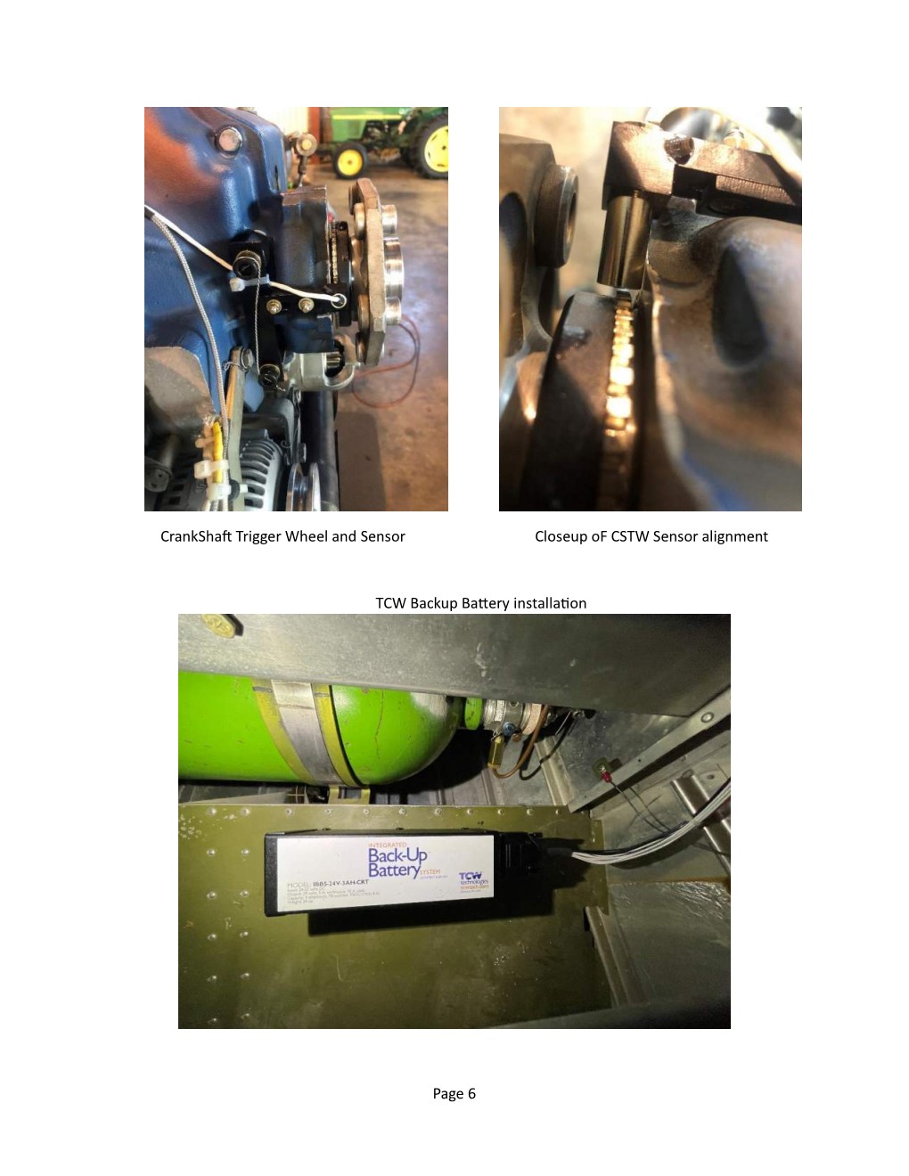

I installed the Electroair dual electronic ignition system in my 1979 TR182 in March of 2023. The engine is the O-540-L3C5D. I am happy with the EA system. I have attached an article that chronicles the installation and initial flight ops. The engine makes more power and uses less fuel than the D3000 dual magneto. The EA system removes the common mode failure associated with the D3000 Mag. I would typically operate the engine as follows: MP 23", RPM 2200, FF 13 gph. With the EA system, MP 23", RPM 2200, FF 11.7 gph. CHT are slightly higher 370-380 F. The airspeed is the same in both cases. I am happy to answer any questions that you may have.

Great question:
I tried the full curve and the top flow curve. I found that neither was satisfactory. Both of them allowed the engine to overheat (CHT>380) during ground ops. I did not see any advantage to the curve since I run 23" MP and the advance curve is basically complete at 14 degrees BTDC. My controllers are not programmed with an advance curve. This keeps all of my CHTs <385 F in all phases of flight.
