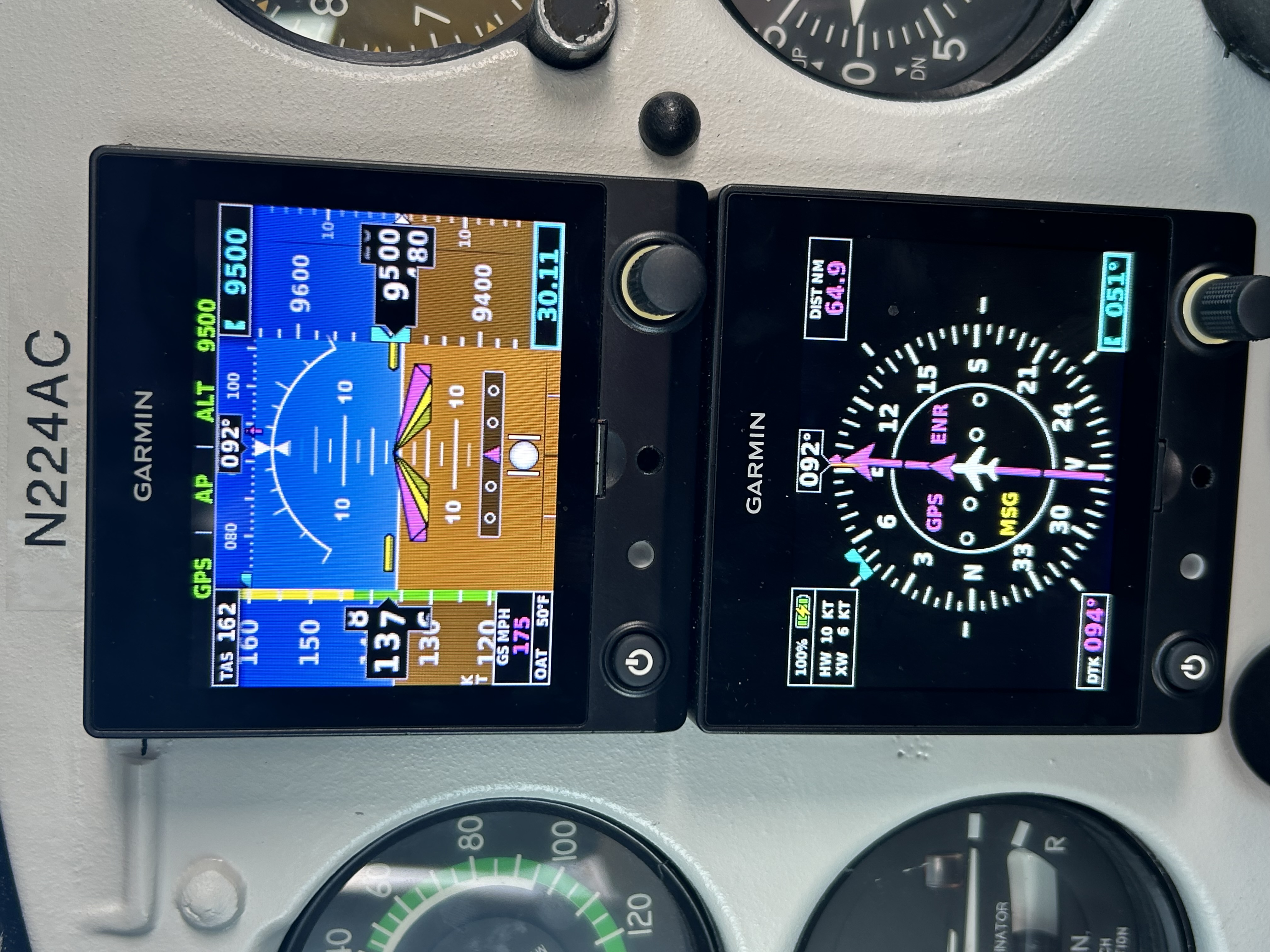

On trip last week at 9500’ making 23” MP @ 2350 RPM, 50F LOP at about 13gph we were seeing high 150s to low 160s TAS. Engine is IO540(300hp) making approx. 60% power. See more details in Trip Talk section.

Scott, how did you get the headwind and crosswind components to each display on your 2nd G5?
I have two G5's as well set up like you with the top as an AI and the bottom as an HSI, but my HSI just shows total wind direction and speed.

Todd, Not sure on the #2 G5 wind reporting set up. The installing shop configured and we’ve not changed it. Will look into further after the holidays and let you know.

Sounds like your Garmin dealer does not understand the question. Hi do have the GAD29 and I do have Wind reading.
The nuance is my G5's simply display "Wind" and the speed. That's it.
Yours however displays further stratification of the wind broken down in to the "crosswind" component displayed as "XW" on your display and the headwind component displayed as "HW" on your display.
Trying to figure out what makes the G5/GAD29 display both wind components, vs, the overall. Is it a software setting or a software version?
Hopefully that makes sense to your dealer. I will ask my shop as well.

Maybe this is the answer: "So today I checked my G5 HSI to see why it shows wind data as direction and speed rather than headwind and crosswind components as in the photo from an OP. Turns out all I had to do was scroll the HSI to the setup page (in flight) and select wind data in headwind/cross wind mode!!! That way I can still do a PIREP using direction and speed while being able to check optimum altitude in terms of headwind/crosswind as well as during landings..."

Interesting - will check the G5 HSI Setup page next time while in cruise to see what options look like. Our Garmin dealer says he'll check the install manual and advise as well.
